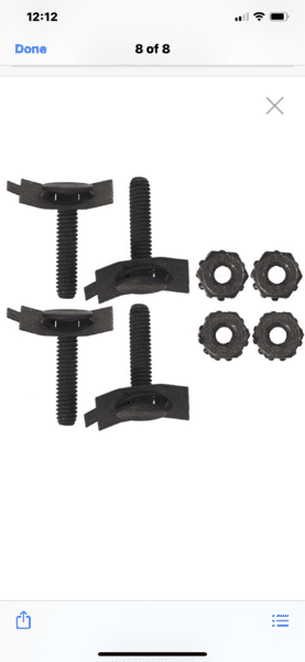

Ok I know I can just Jerry-Rig some stuff to mount my Retrosound dash speaker, but would like to see a picture of what the correct OEM hardware looks like. Some dummy :BangHead: stripped his dash for paint and now He can’t find the correct screws/studs and pal nuts.
Are these what I need??
No studs and pal nuts on 70 RR speaker. There is a separate bracket the speaker mounts to and they use small bolts that thread into the speaker frame. Then the bracket gets mounted to the underside of the dash. 2 studs hang from the dash and pal nuts retain the bracket & speaker combo. This is how the factory did it. Here is photos of it.

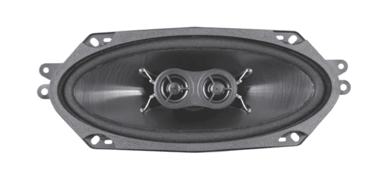

I have the bracket and it is a thin Speaker so it doesn’t hit the heater controls. I see the holes in dash, but no speed nut clip or anything for the screws or bolts to thread into.This is the speaker.
