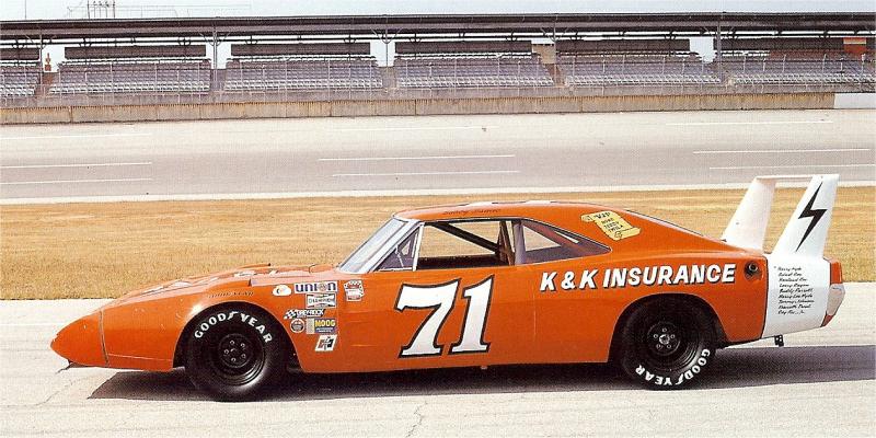

Are the two wings the same? Can they be swapped? Anyone know the dimensions or how to tell the difference between the two? Thanks guys and Happy New Year !!!!

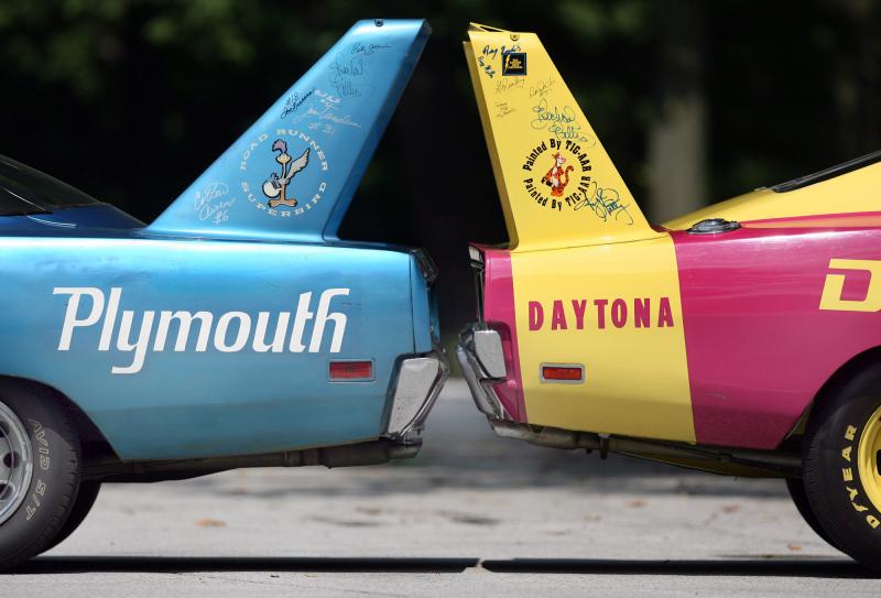

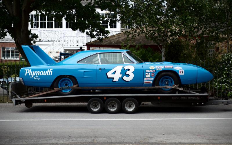

I think they're different. More swept back on the bird and it looks like the uprights are thinner at the wing
Here's another pic
completely different wings, not interchangeable
I found some specs online that said the Daytona wing is 17" high and the SB wing is 24" high. If you look at the back to back pics, there doesn't seem to be a 7" height differential between the 2. Could be an optical illusion because of the different angles with the Daytona more vertical.

again, complete different wing assemblies....'Bird wing is taller and more swept back, Daytona is more upright...they will not interchange
