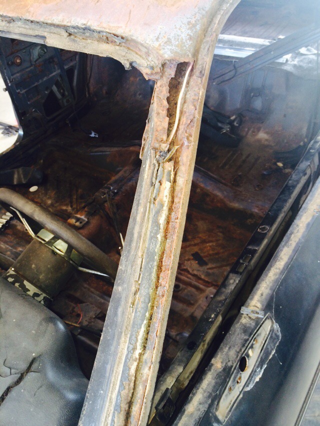

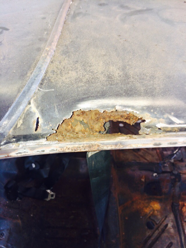

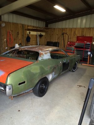

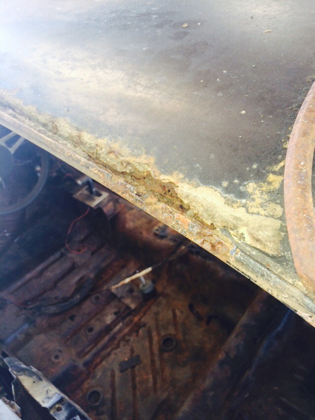

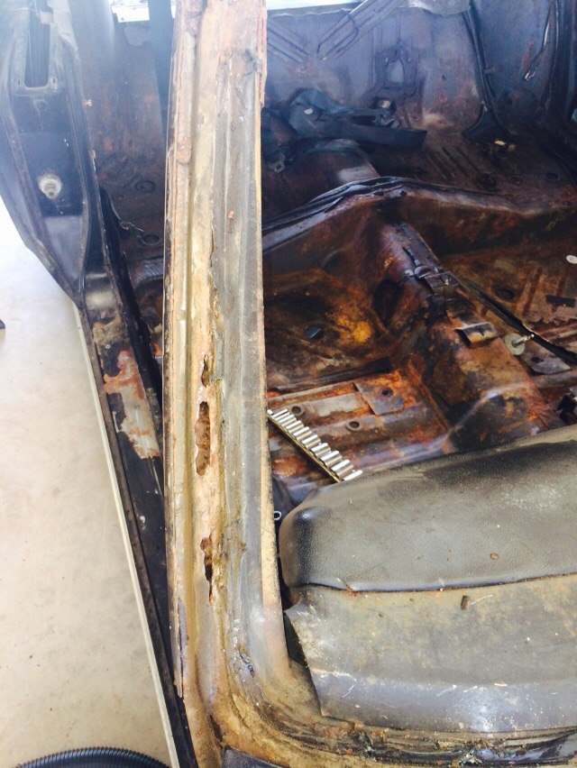

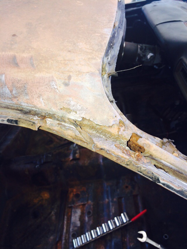

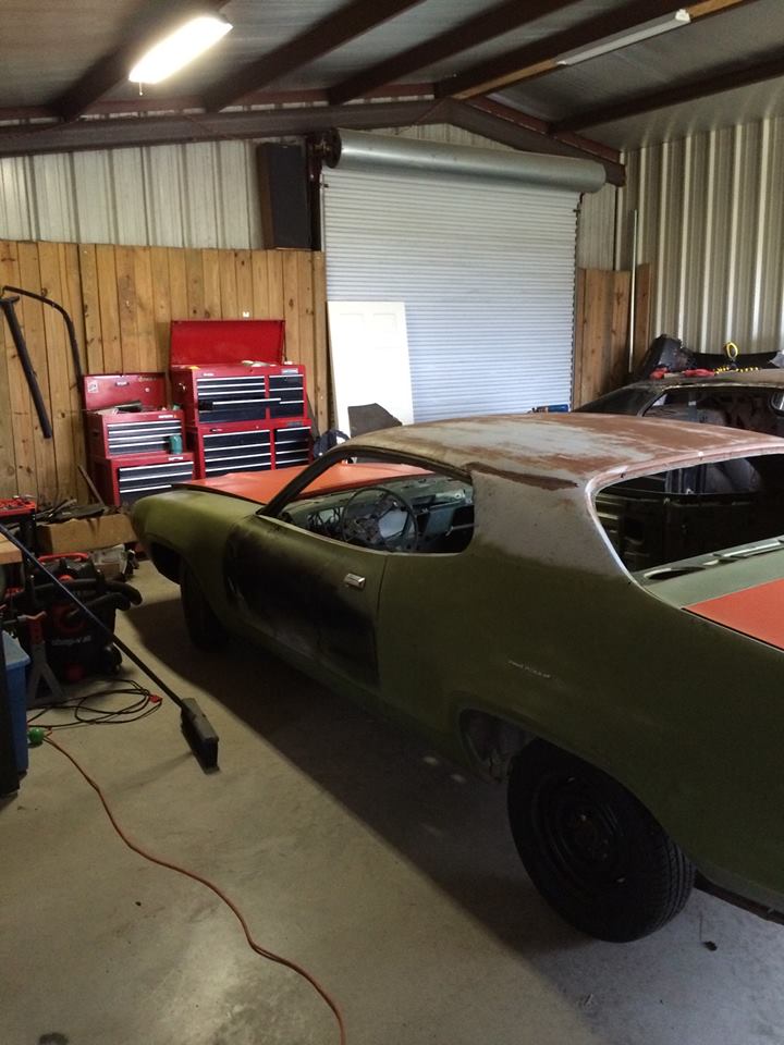

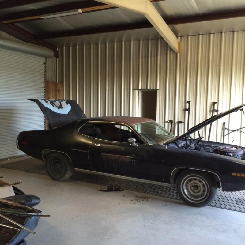

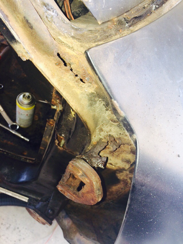

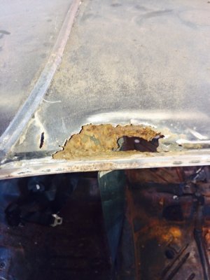

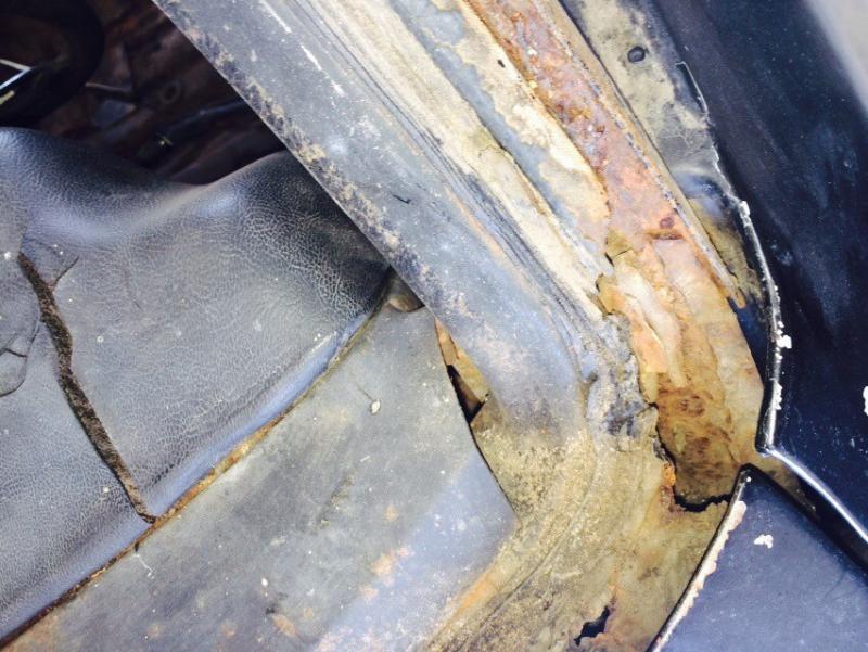

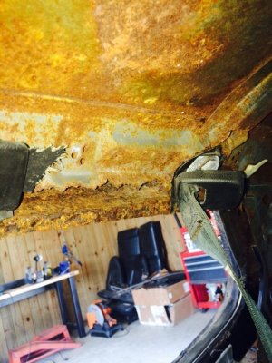

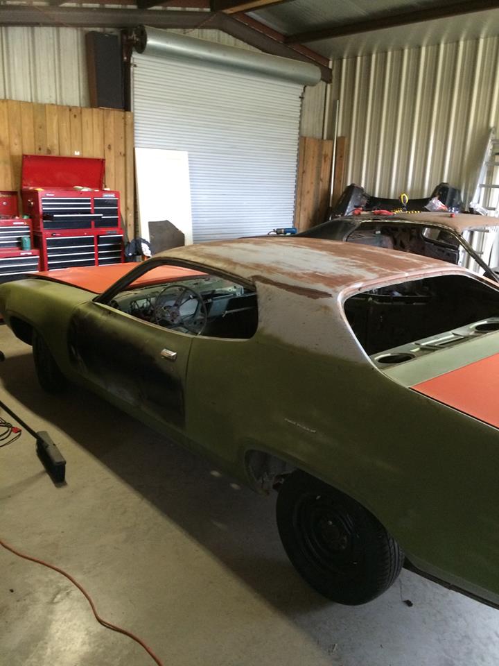

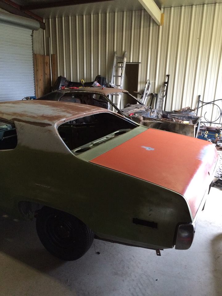

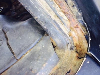

Now that hunting season is all but over I can transition over to working my car. I picked up fairly rough 71 all numbers matching GTX many months ago and just started working on it. It needs new A-Pillars, Roof Skin, Patching on some of the roof bracing, floors, trunk, lots of other rust patching. I bought a 71 Road Runner shell the other day as a possible donor car, but after getting the car home, it fairly solid with very little rust to deal with. However, the road runner has no fender tag or BS, but I can't bring myself to hack it up. So I am wondering if the time and effort of getting the GTX ready would be better spent on the Road Runner. Thoughts?
GTX Pics:
71 GTX - 1.jpg 71 GTX - 13.jpg 71 GTX - 14.jpg 71 GTX - 15.jpg 71 GTX - 16.jpg 71 GTX - 18.jpg 71 GTX - 19.jpg 71 GTX - 20.jpg 71 GTX - 24.jpg
RoadRunner

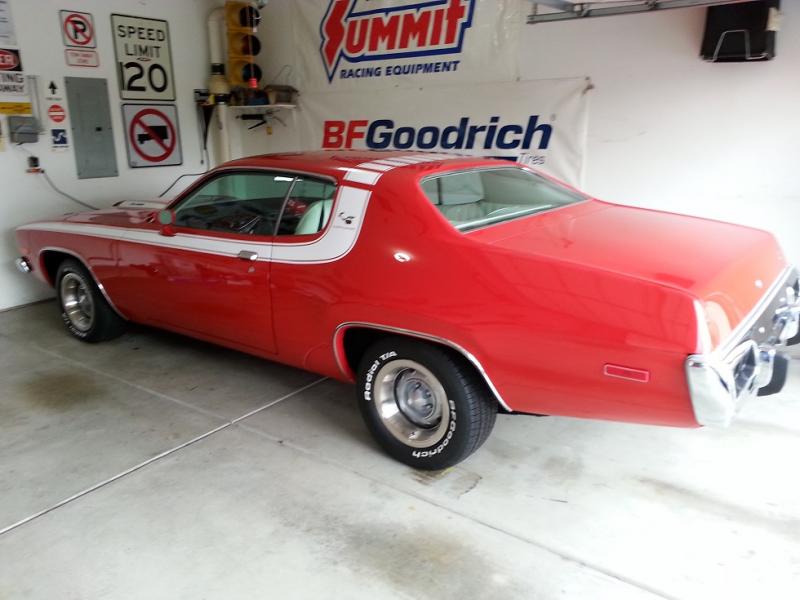

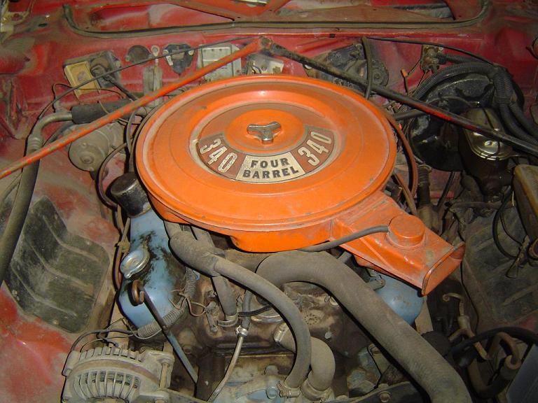

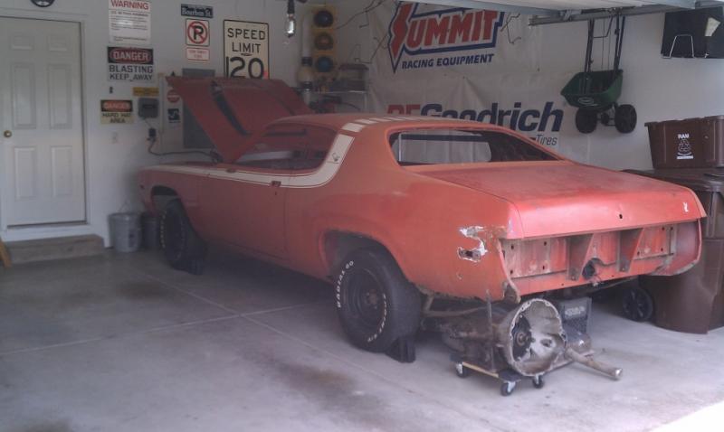

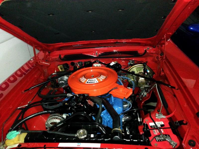

My 73 Roadrunner does not have a BS or fender tag, and I sunk a lot into her, but I have also had the car for over 30 years, so there is that connection and why I restored her to her former glory!!!!!
She went from this....
To this....
And this....
to this.....
So there is hope at the end of the tunnel no matter what you decide to do.
I honestly don't think the GTX is worth saving with that much rust damage. Maybe ten years ago yes, but today... no. If you are not a professional restorer I would bet money that project would wear you down and break you long before you got it on the road. I would suggest keeping the Roadrunner and getting it back on the road and sell the GTX and apply those funds to the Roadrunner project.
man thats a lot of rust ..I would do the RR and really think about what to do with the GTX after I'm driving the RR .. me thinks you will sell it to the next guy to put together ..especially if resale not the important issue

The bird looks to be in better shape. I sure in the heck wouldn't part it out. I guess if resale is a worry, just build your roadrunner in a resto-mod, pro-touring or custom type fashion, and done right you could break even or even make a buck depending on the route you go (being you'll be doing the work). The market is a lot more hot right now for those cars vs. someone trying to go original, but missing documentation/tags. Resto-mod/Pro-touring/Custom jobs, Broadcast sheet & fender tag doesn't really make a pinch of difference anymore anyways.
If I was in your shoe's with two cars like that (wish I was), I'd build the roadrunner first, then wait to stumble on a cheap satellite to snatch the roof/pillars from for the GTX. When going to swap the roofs out, I would find a car that I could cut at the bottom of the A-Pillar's and lower C-pillar's and graft on to the GTX. Trying to disassemble the roof skin, roof framing, pillar's and drip rail laces on both would take hundreds of hours to do, and believe me, it isn't fun.

I think I am going to finish stripping down the GTX and get blasted/primered, then start on the RR. The GTX is a basket case right now, but I think it is worth saving even if it means fixing a few things at a time. A lot of good points were made on both sides of the issue and I appreciate the input. I have a line on a complete roof from Moparmark, it's just a matter of working out the logistics to get it shipped.
I like that GTX. I saw it on ebay a couple weeks ago. Triple black and 2 tags. It's definitely worth saving but man o man, that's a big project. Not for the faint of heart or skill.
My advice as far as the GTX: Don't buy the panels you need individually. Buy a whole parts car. A super SOLID parts car. If you try building that thing by buying each panel individually, you are going to spend a FORTUNE. Figuring shipping and the high cost of, even, used panels not to mention new.... Don't get in a hurry to find the right parts car either. It might take a while. In the meantime, you can disassemble that thing and have it soda blasted, then epoxy prime it so it doesn't continue to rust.
