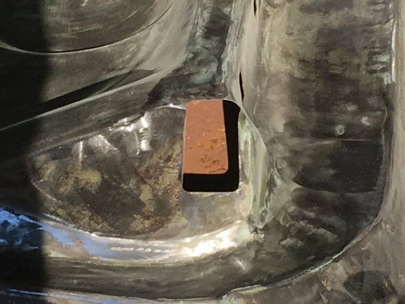

Ever looked inside you’re deck lid? Thought mine was in good shape until I took a good look.
Has anyone coated the inside with rust inhibitor? I’m at least considering shooting it with spray lube after I paint.

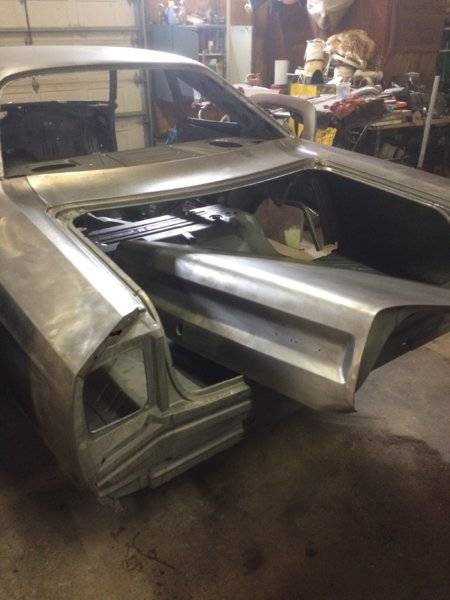

I have used two deck lids. One with a good inner structure,and one with a good outer structure. I peeled off the bad decklid skin off the good inner and set it aside. Then I carefully cut the inner structure from the other enough to pull out of the pinch seams. Then I straightened the folded edge enough to test fit it on the other inner structure,leaving the rear edge almost alone.
I blasted the inner structure and hand strip the outer lid so as not to warp it. They got 3 coats of epoxy followed by NVH (flutter) foam in the factory spots.
This way you can hook the back on the inner structure and set it down,then proceed to dolly the edge back down.
I don't have pics of the decklid procedure but here is a hood I did.
https://www.forbbodiesonly.com/moparforum/threads/1969-coronet-500-convertible-resto.98907/page-3
