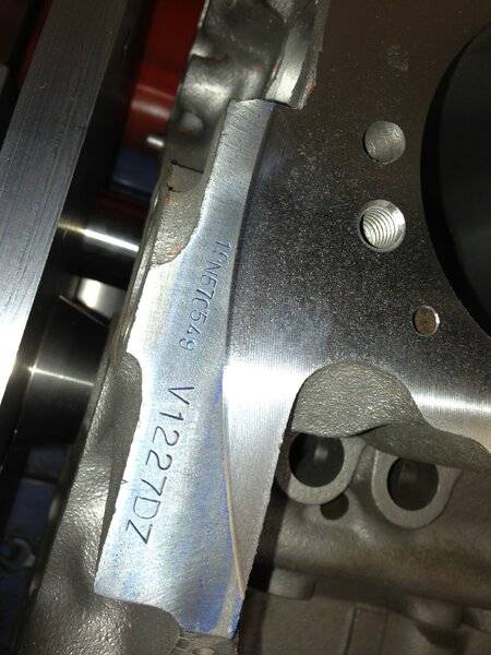

My engine builder wants to deck my Numbers matching block and take a little off on the heads to clean things up. He says he strongly suggests it. The problem I have is the HP, date code and engine number will come off the pad. I have plenty of pics of the original stamping and still have the VIN stamped by the motor mount and casting numbers and casting dates. For the sake of the motor I do want to have it cleaned up but will it hurt the value when I get it all done? Just want to others opinions. Its a pretty much stock rebuild but the block had to be bored.
You don't mention what engine you have, but I assume it is a RB block. I agree with the shop that it should be decked, but since the intake does not seal to the valley rails, it is not necessary to cut them and remover the stampings. Just cut the block decks to match, and leave the rails (valley) alone. Cut the heads 0.010", and take 0.010" off of the intake surface of the heads and you will be fine.

Now, I looked at pics of a "B" block, and the stamp pad is in front of the pass deck, and at the same height. To that point, a good machinist can stop the mill before it hits the stampings as the pad is quite large. It is possible to miss the stampings, they just have to pay attention.
you want to see close? This is a '69 DZ 302, numbers matching $100000+ Camaro. I was at a "Pucker Factor" of 10 on this one... I had to file the lower part of the rail in the pic because I could not cut any more safely.
