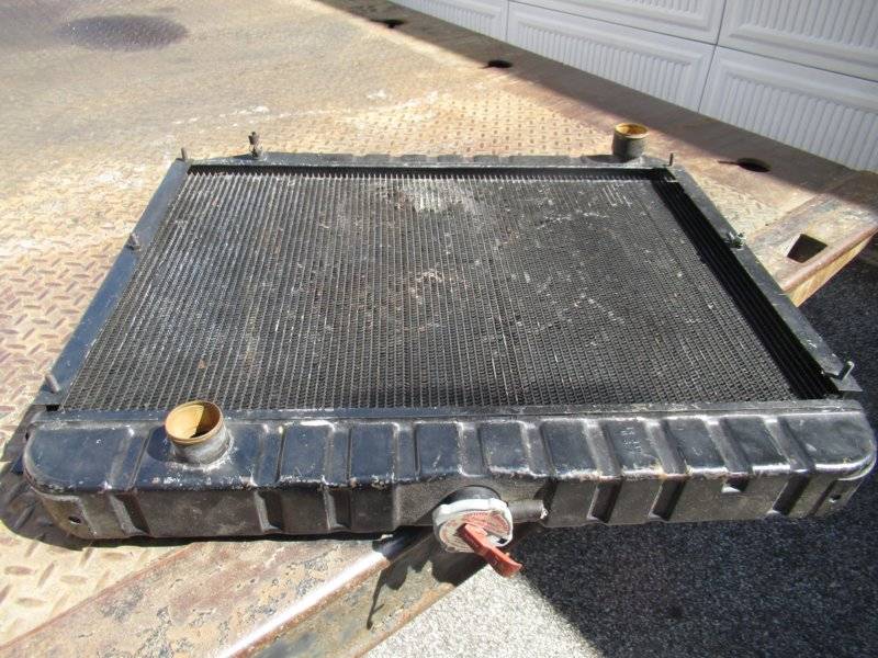

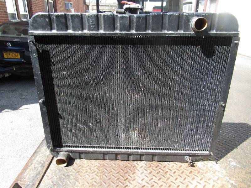

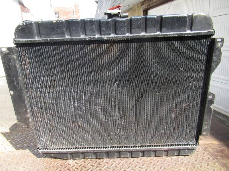

Hey guys,

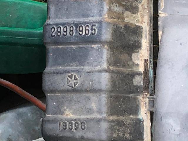

I have a 26" factory radiator that looks like it is for a big block due to the hose nipple positions.
The number on it is 2998 965. It has a shroud on it.
I can't find what this is supposed to fit. It looks like I can get it to fit in my '70 Charger project car. Currently the Charger has a 22" opening in the core support but that is easily changed, right?
It will need to be boiled out, I'm sure.

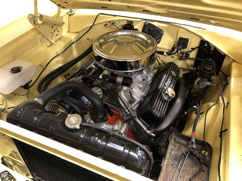

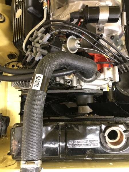

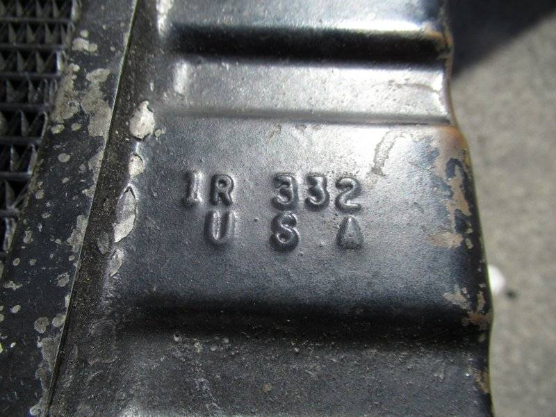

I just put a C 68 body rad in my 69 B body. 22” to 22”. I used this rad as it was free and a new 3 road record too. If you want to open up the opening to 26” you’ll have to cut it which I can never seem to bring myself to do. The other thing you may want to check is the height of the rad and exactly where the brackets are located in relationship to the factory b body holes and also in relationship to the bottom of the rad and rad support.
I had to oval out the top holes on the side brackets by about 1/16 - 1/8” (IE: not very much) and then just redrill the bottom location all together and use a bolt and nut, not the factory B body locations. All of this was done in order to get the rad off the rad support at the bottom. I made it so there was an 1/8” gap between the rad and the support cradle. If yours is off too be careful to keep it as tight to the cradle at the bottom without touching as the clearance at the top is tight in a few spots near the rad cap and hood bracing etc....
The other thing I had to do was to use a C body upper rad hose as it was on the opposite side as compared to the factory B body location. Included a picture of the part number in case your hoses are in the same location.
