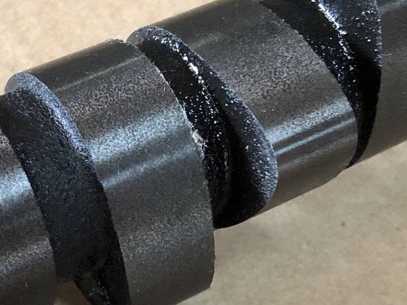

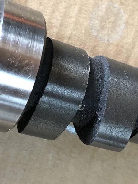

Defective NEW camshaft. Ever seen one like this?
Yeah, that is what I'd say. It doesn't look like anything but casting sloppiness but since the grind of the lobe is even, I'd use it as is. Mine looked like a narrow strip of grass left UNmowed in the yard.

Nothing wrong with that as long as nothing sticks up above the lobe. Not pretty; but doesn't hurt anything.
Ok thanks for the advice, I'll leave it alone. I'll also have a close look at the existing cam that comes out as that's a Schneider too, just a different grind, and has been fine for the last 5,000 miles. I'm interested if there is the same sloppiness in the finish. If it was my company, I think I'd spend the extra 10 minutes per cam cleaning them up so nobody had these concerns in the first place.

Deburr it. It's a casting. They dont machine the sides of the lobes. Doesnt look that unusual for this style cam. Its not a fully machined billet roller. No parts get installed without debuting and cleaning in my stuff. They all need a little work.

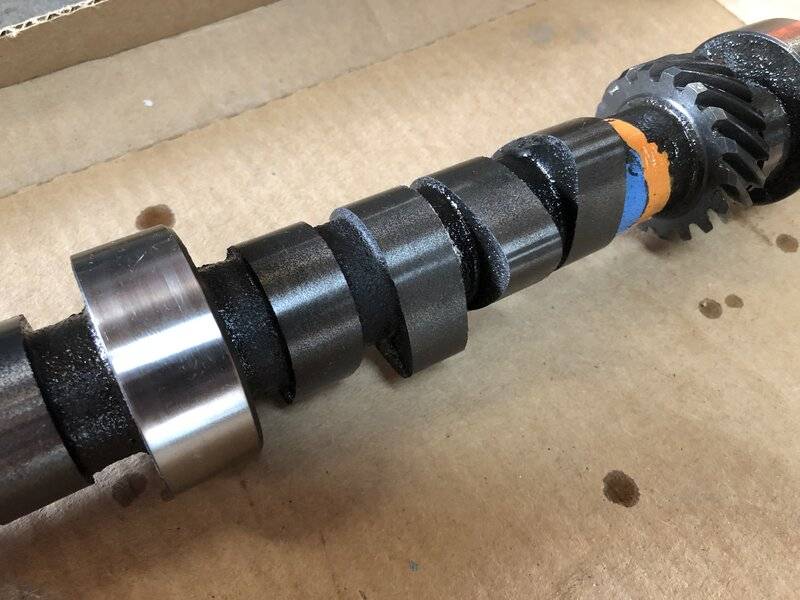

For those of you that have stumbled into my thread about the build of my wrecked 1970 Charger XH, I am rebuilding the original 383. The crank and pistons are in and yesterday I started to install the cam.
It is a Comp Cams 270/470 Magnum series.
I was slathering on the cam lube and as I was smearing it on with the cam lobes in my right palm, I felt some rough unfinished edges that cut my hand a few times.
View attachment 1012018 View attachment 1012019 View attachment 1012020

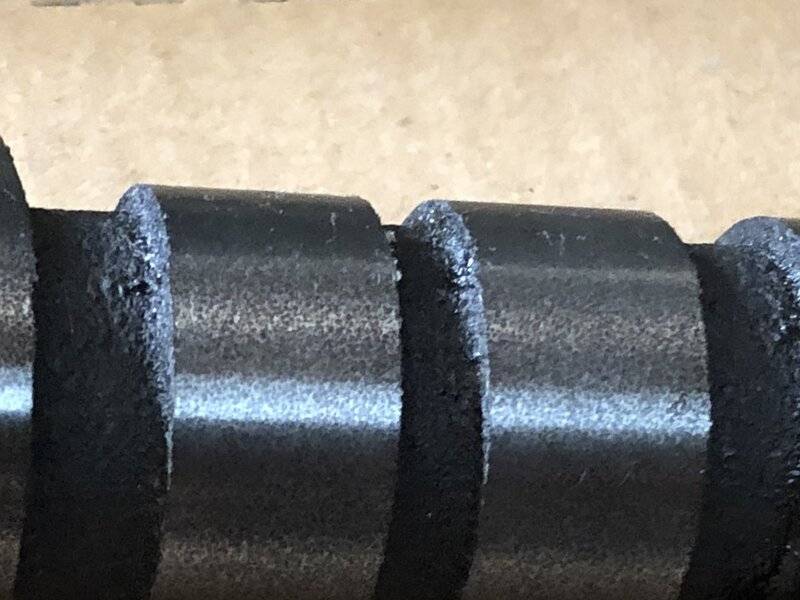

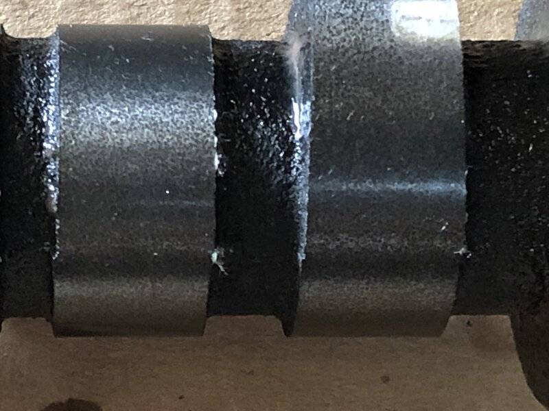

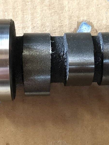

Take a closer look. You will see at the edges of the lobes, some fabric remains where I used a towel to clean off the lube.
These spots are right on the outer edges.
That one above was the worst.
The lifters ride along the middle and edges of these lobes. I thought of just taking a file to the edges but what if I cut through the hardening treatment? Why should I have to do that anyway?

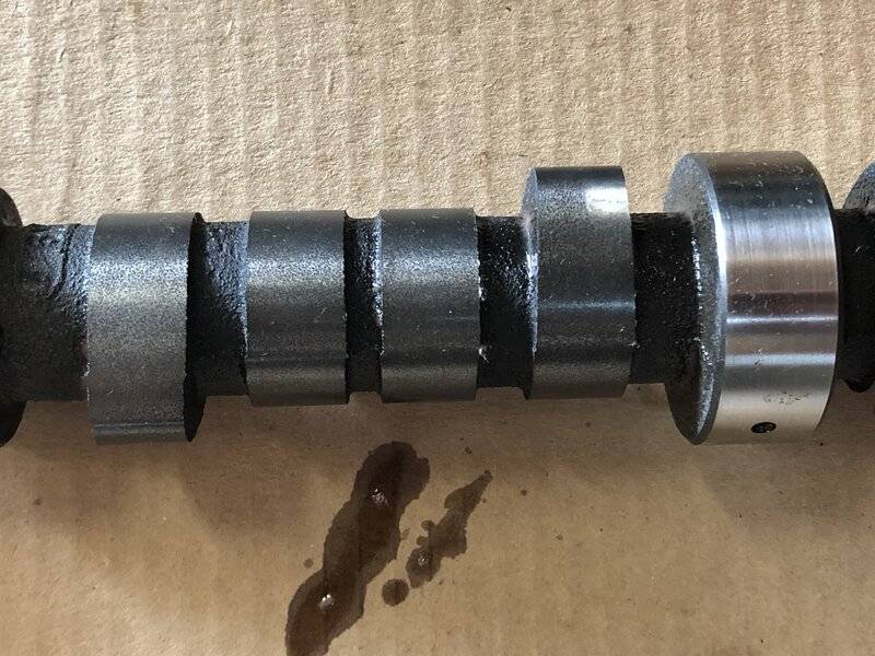

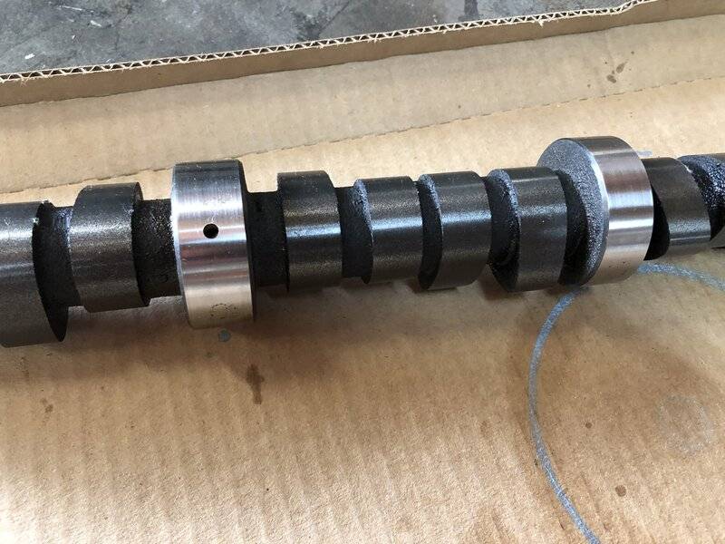

I haven't seen this before. I've installed maybe 20 cams over the years and this is the first one that I have seen like this. 7 of the lobes have sharp, raised edges on them.
I've never seen cam lobes that rough. It looks like they were unfinished.
Looks like the typical junk that Comp Cams is making these days. They have really gone to ****. They'll never get another dime from me.
