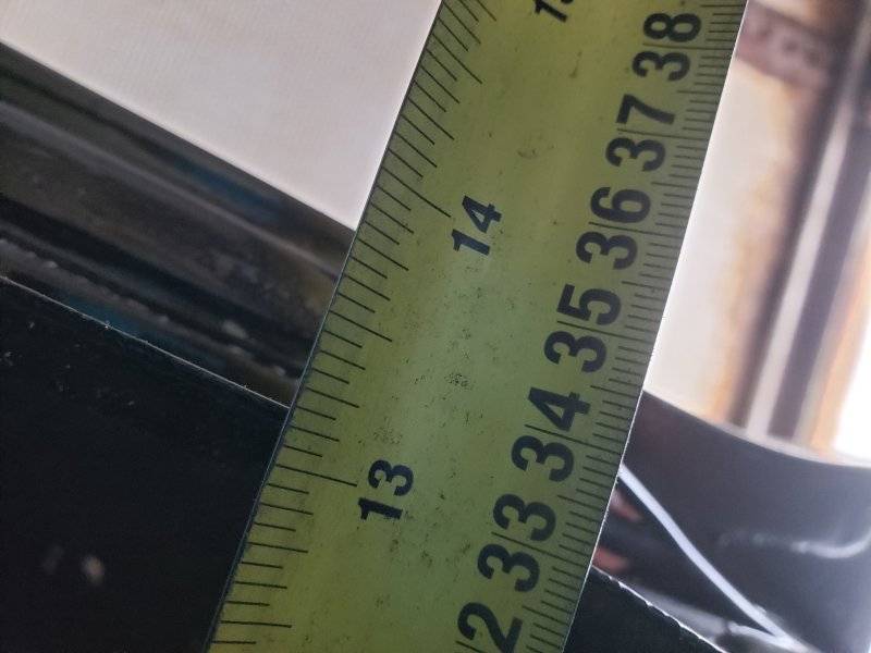

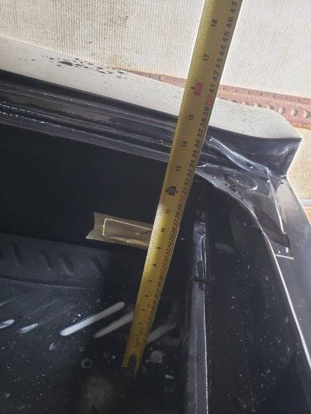

This is not the exact area that you are asking about but close. The car has trunk floor pan installed but doesnt have tailpanel support braces installed so the measurement is from the trunk floor to the trunk gutter.
the trunk latch support should determine that distance......I cannot remember the last time I used a tape measure assembling sheet metal, probably because I never have........ as Don said, screw the car together, with maybe a tack weld here and there; with doors and trunk lid bolted on, it will all only fit one way.
I had a friend of mine give me the exact same measurement this morning and yours is dead on with his so that makes me feel very confident to go with that measurement. Thank you
