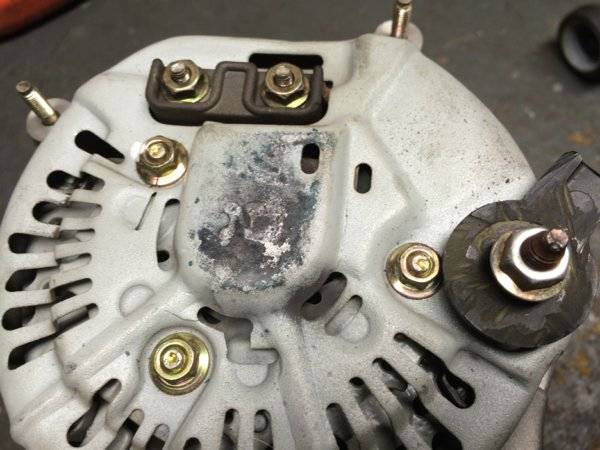

I'm installing a Denso mini alternator and have a question.
Can I jump the sensing terminal on the alternator to the main power post or does it have to be switched power. The instructions that I found on line says to connect to switched power but on other alternators I've always jumped it, including the Powermaster alternator I'm replacing this with.
What do you guys do, I'd prefer to not run a switched power wire to the alternator if I can jump it.
Can I jump terminal 2 to 3 ?

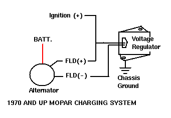

I use the two terminals for the fields and the the threaded stud for power.
The green and blue wires are field but i'm usimg the '70 up charging system.

I have the green field wire right to the alternator but I never connected it with the other

Oops Silver. Got you back tracking now. Sorry. I just jumped the sensing terminal at the alt power stud and will leave it that way unless someone advises me otherwise.

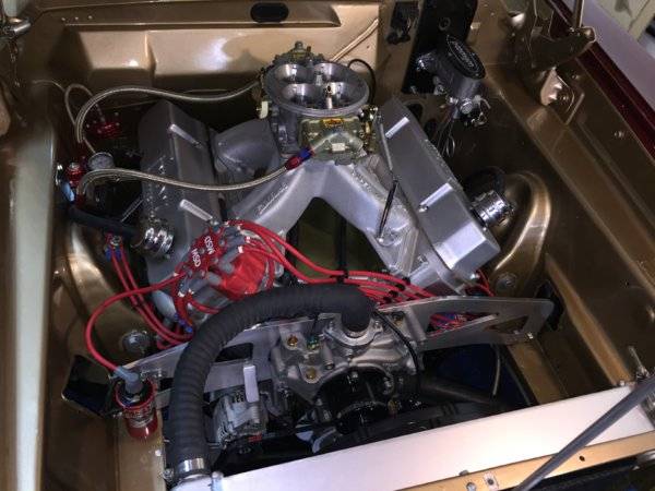

Yes it is. This one came from Hughes but it’s made by AR Engineering. .375 thick.
Motor sits nice and level with it. The previous steel mounts had the left side of the motor up more than the right side.

Hey Hoser, how are you. As a matter of fact yes. Still keeping the wipers, E-brake, horns, etc, fully street legal but I've lightened it up a fair bit. I was surprized but I did the calculations and with this plate and alt upgrade, another 16 lbs came out. That Powermaster alternator I was running was 13.5 lbs alone. It looks like I'm just about done, although, those SR radials are 21 lbs each and QA1 makes some nice aluminum strut rods..
