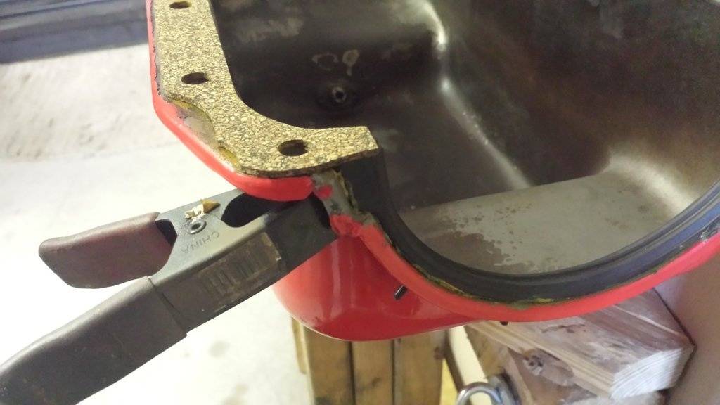

I had to trim down my nibs a bit with a razor knife so they would pull through. I used gasket adhesive to seal the end gaskets and used a few clamps to hold them in place.

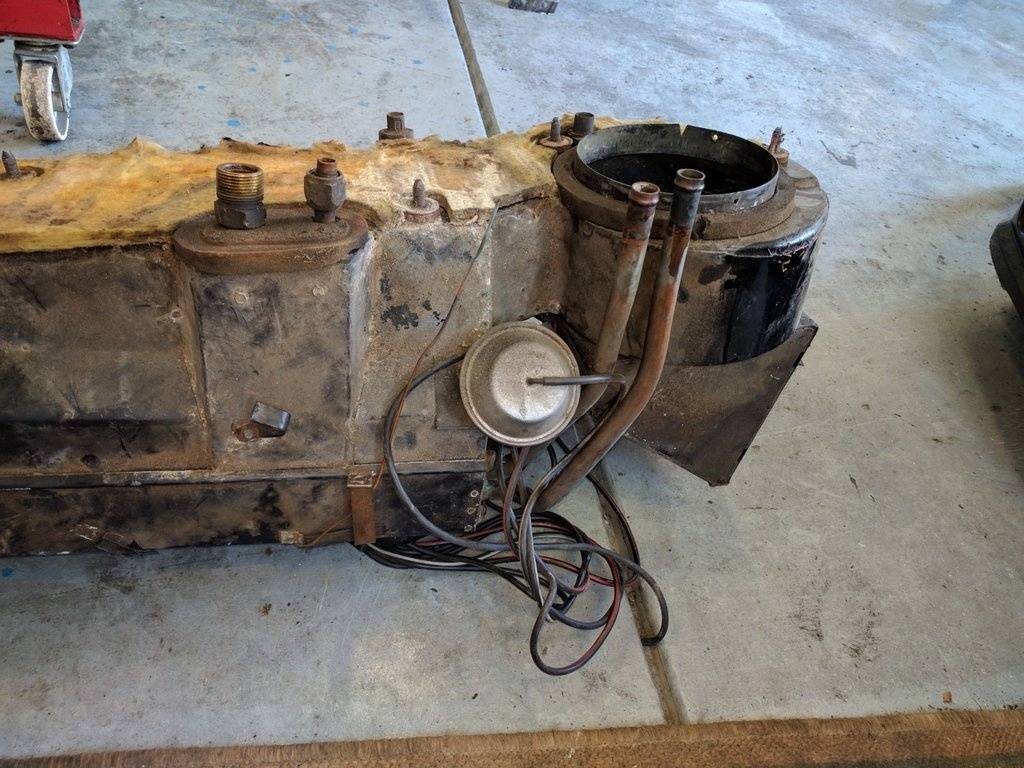

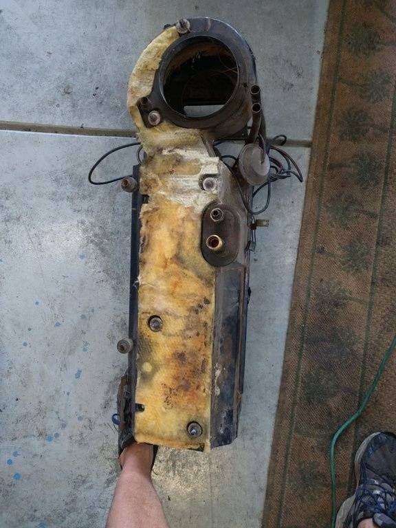

Question #1 - Any tips on getting the water tube assembly apart from the heater core?

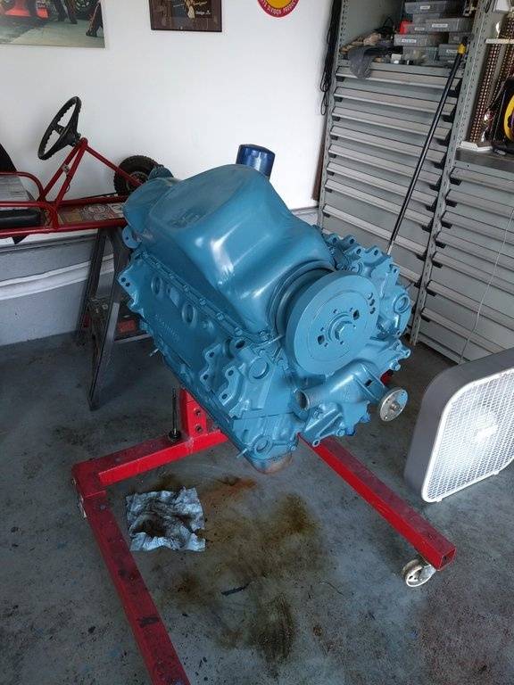

I've been playing around with paint on the engine. I had some plastic coat and the nozzle (actually I think it is in the can) plugged up. I bought a dupli-color rattle can off amazon and that's not so hot either as it seems to collect a lot of unused paint and then dripped an made a mess. I also banged out a dent in one valve cover. it's not perfect but much much better.

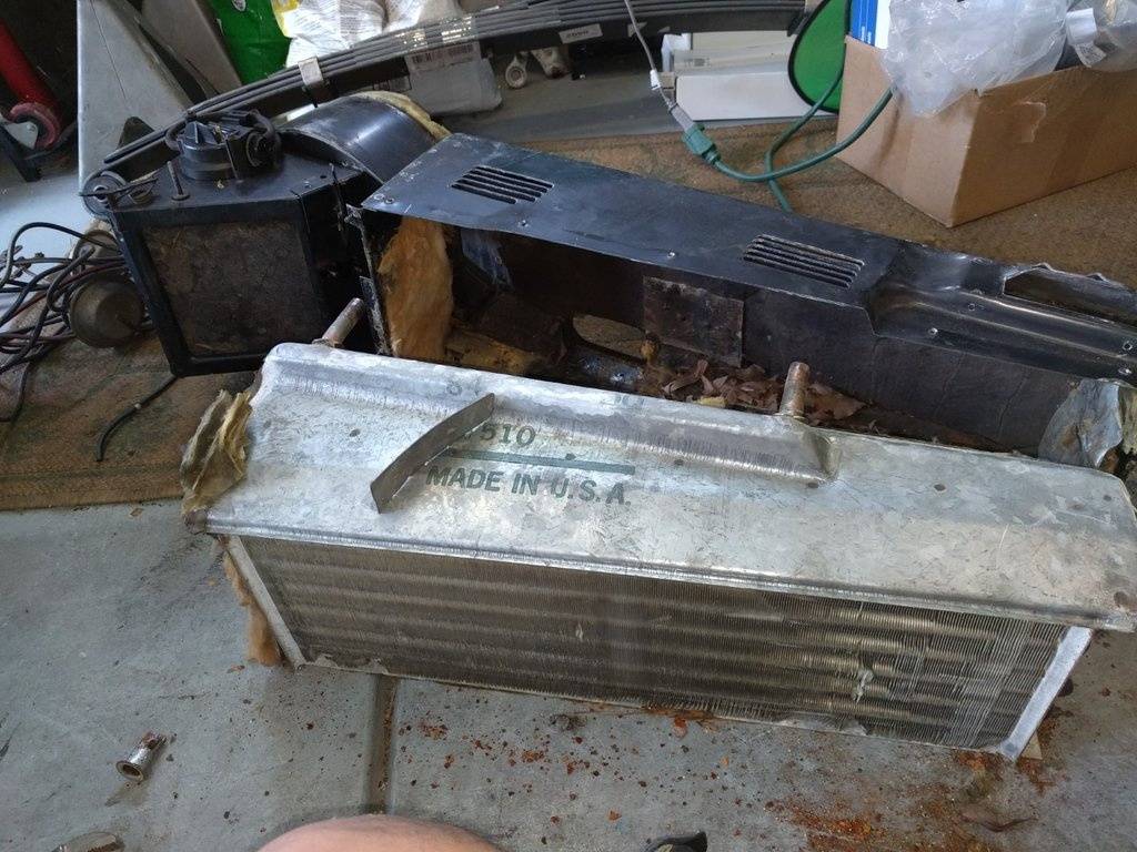

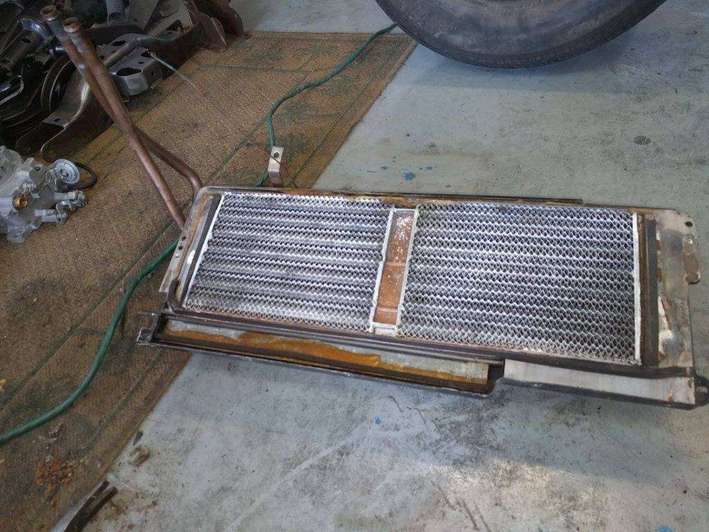

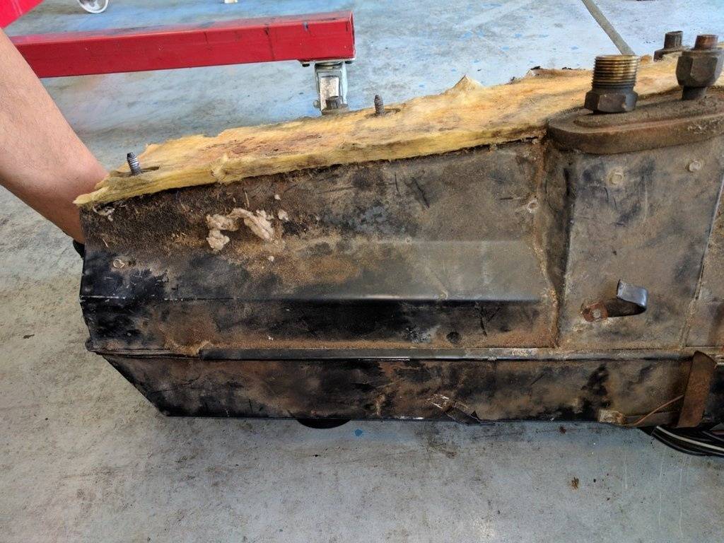

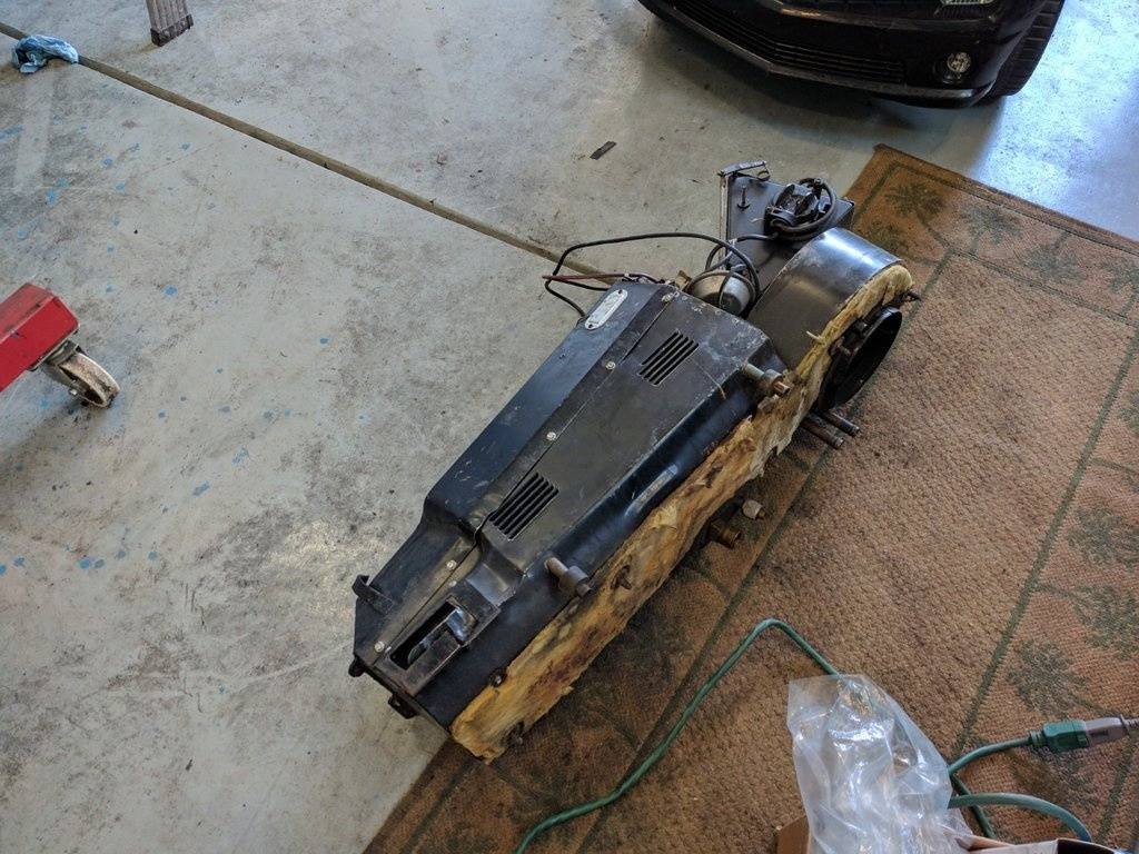

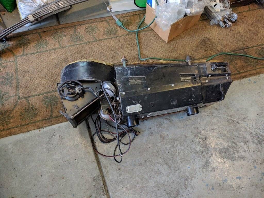

Today I started messing with the HVAC box as seen by the photos below. I got it pretty well tore apart and I will replace the evaporator just for good measure because I don't want to come back later if it leaks. I have a replacement heater core as I know it was leaking or something inside the car with antifreeze was leaking. AS mentioned above I cant figure out how to detach the water tube assembly from heater core. I'm reasonably confident from the shop manual and diagrams I have all the screws and stuff out it is simply that the outer tubes are stuck on the inner tubes. Should I spray some penetrating oil on them?

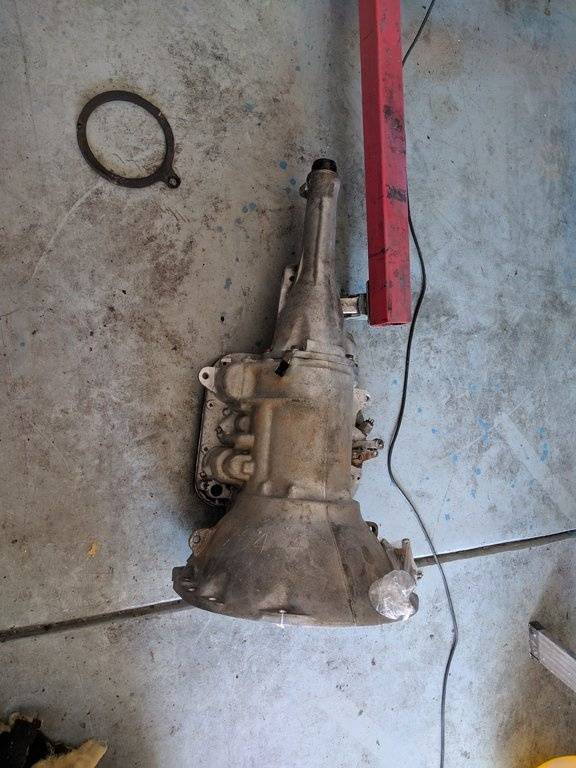

Got the Trans back from the rebuilder yesterday, quicker than I expected.

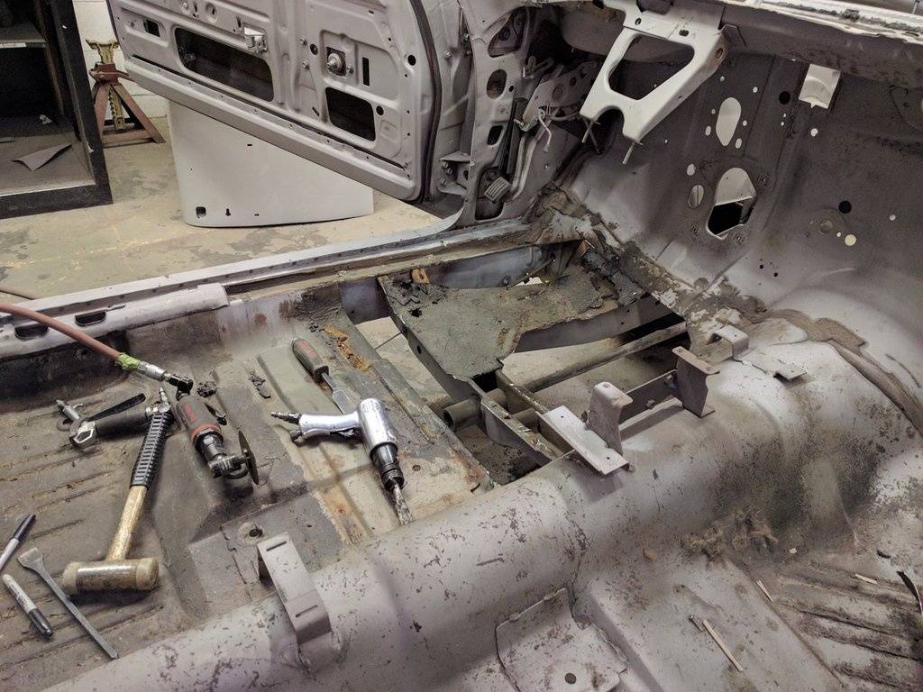

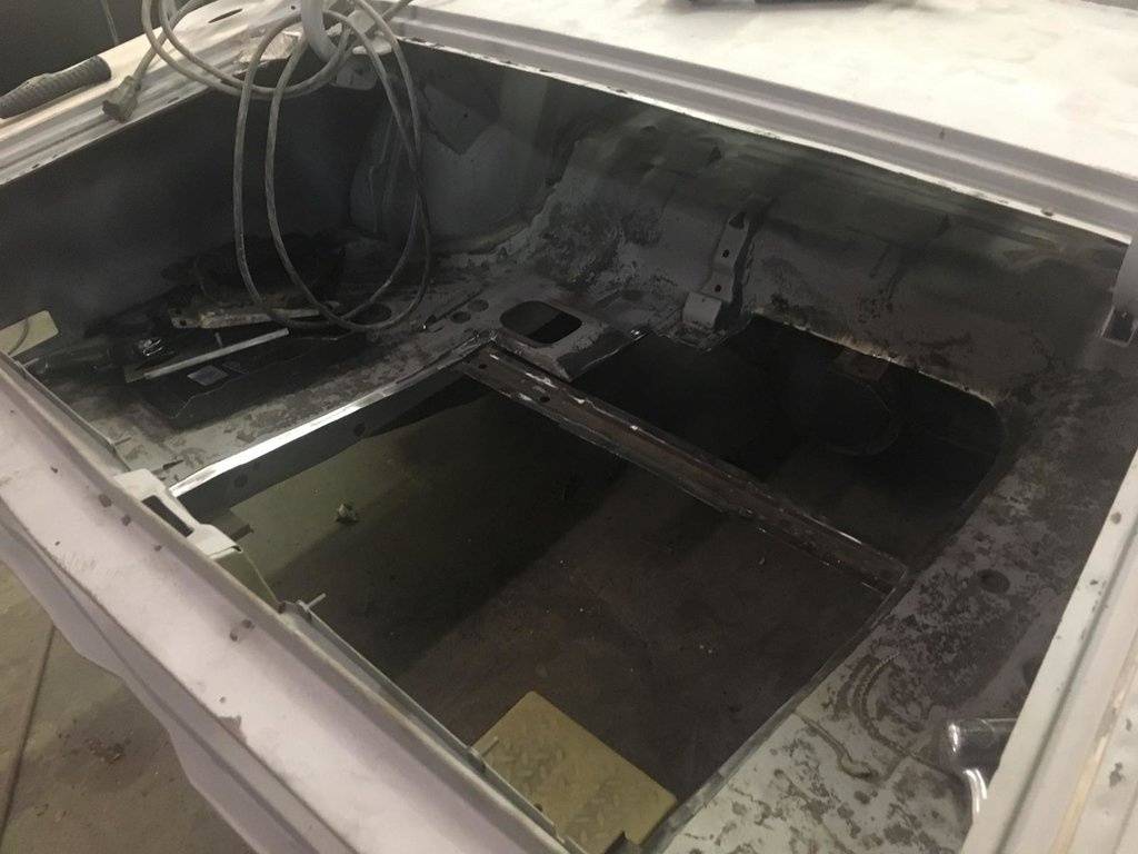

Also stopped by the shop replacing the cancer and they finally got to work on the car and started cutting.
I ordered an evaporator coil and a deluxe heater box insulation / gasket kit thing from Original Air Group. I already had a new heater core from a while back so Once the new order items arrive I can start rebuilding the heater box .

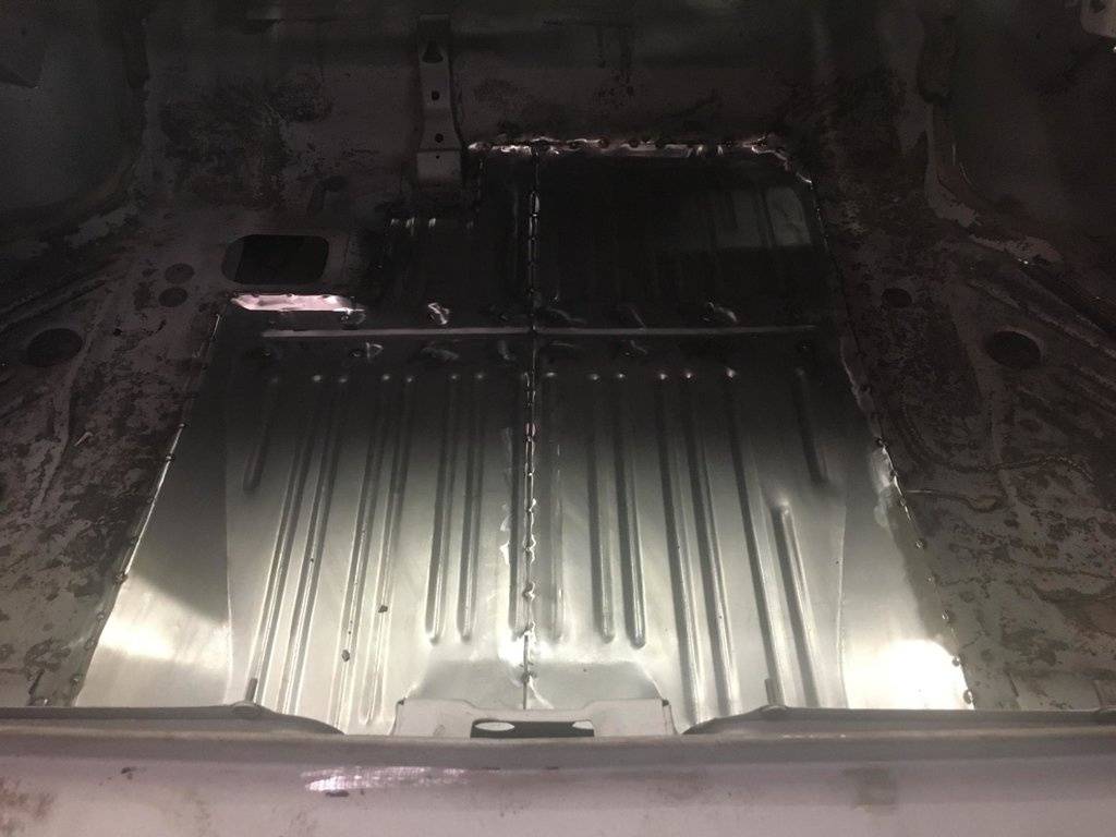

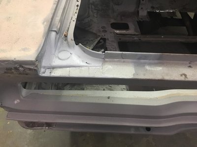

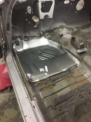

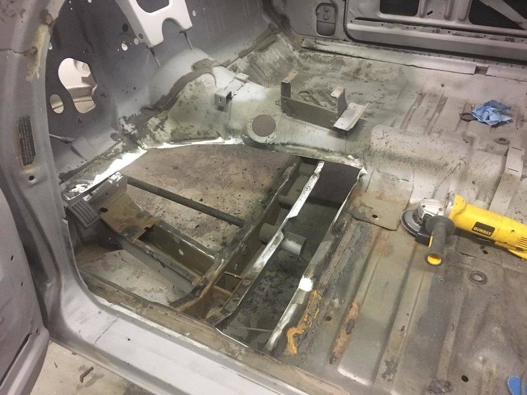

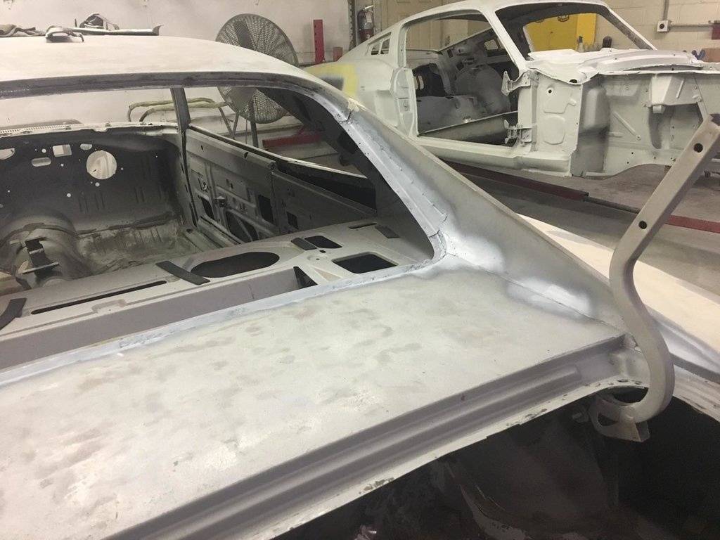

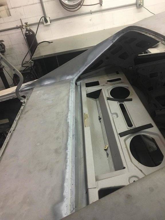

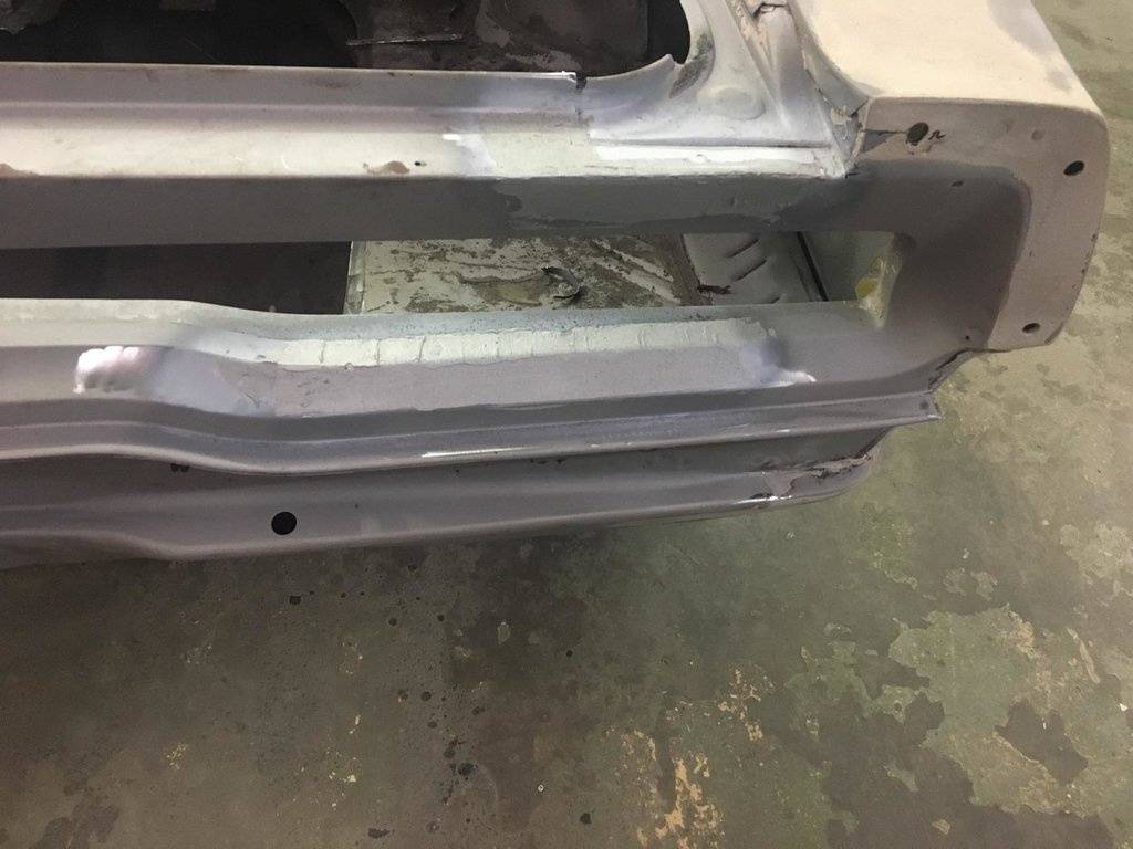

I haven't had a chance to work on the car myself, but progress was still made. I received some parts I bought and the shop has made good progress on the car. Here is some photos of the progress they made
image000000.jpg image000001.jpg image000002.jpg image000003.jpg image000005.jpg image000006.jpg
The shop also hit the rot on the inner fender at the battery tray and replaced the wire harness tabs on one valve cover.
This coming week the shop should install the new rear valence I bought and then they will start working on paint. At this stage we are gonna do floor boards inside and out, engine bay / firewall inside and out, and jambs. Then I'll get the car back to do suspension, drive train re-installation and interior firewall build out, before we do the majority of the paint.

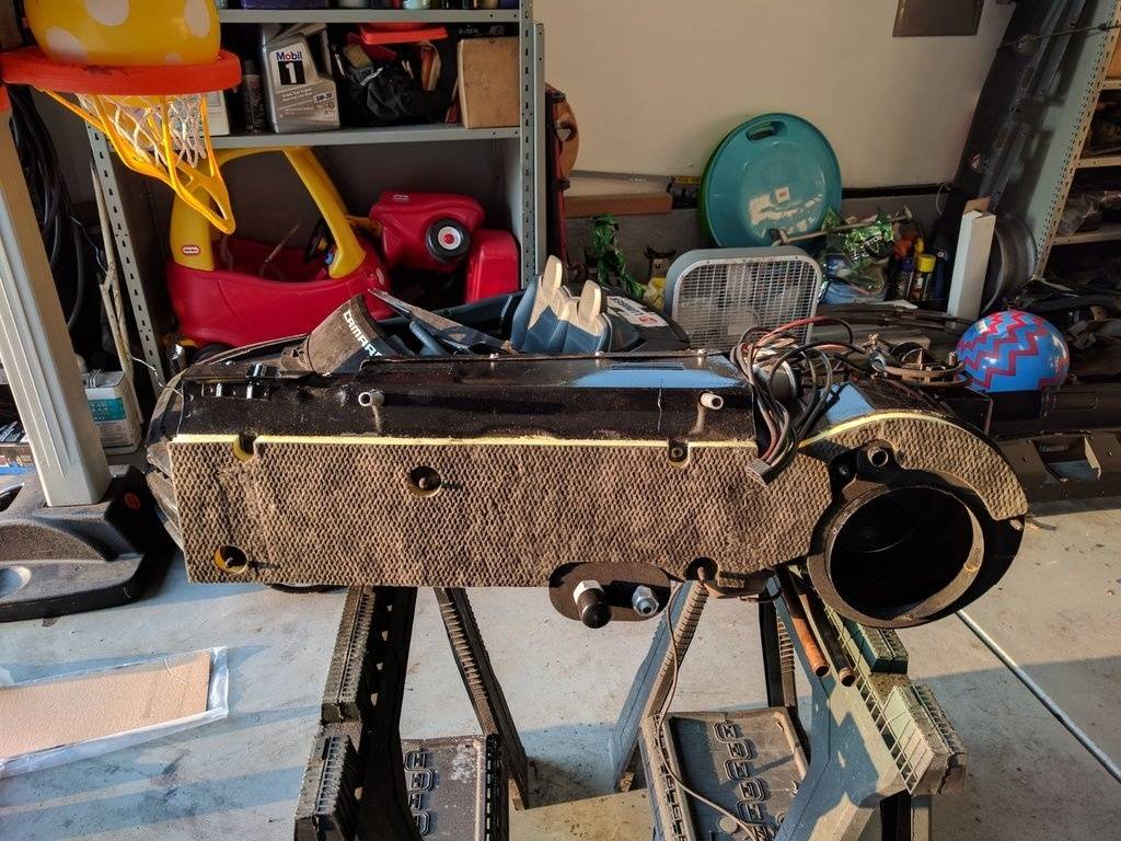

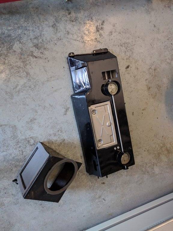

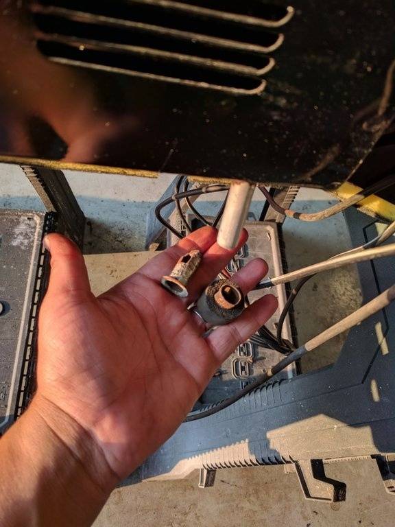

Put the heater box back together. Does anyone know where to get the little end cap things. I didn't know to save those until too late. someone has got to be repro'ing them but Year one doesn't have them in the catalog.
