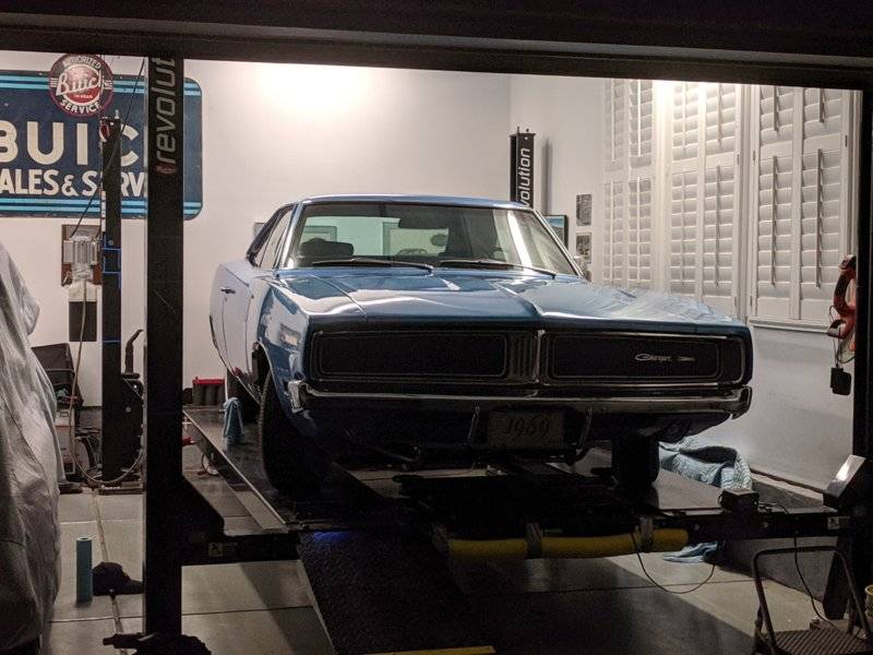

Got the underside detailed, adjust the the linkage (still not right), did an alignment (need to sort out caster and camber still but the steering wheel is straight), connected the speedo, installed the new antenna base and wire, cleaned the windows, buffed a couple missed spots, and installed some various decals.

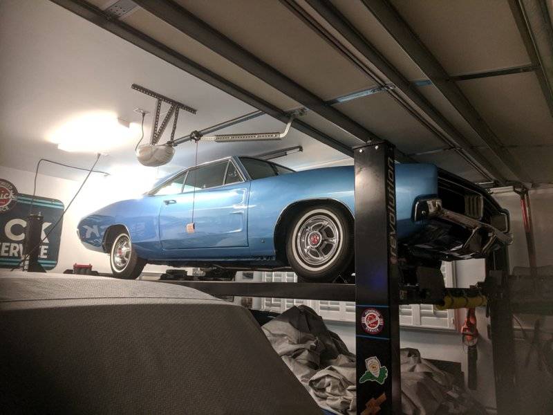

Got to clean up now to put the Superbee away for the night.

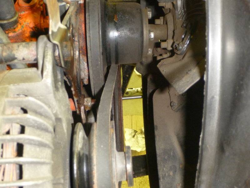

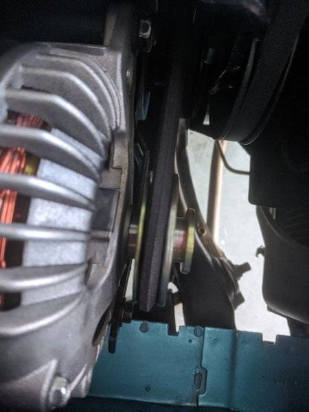

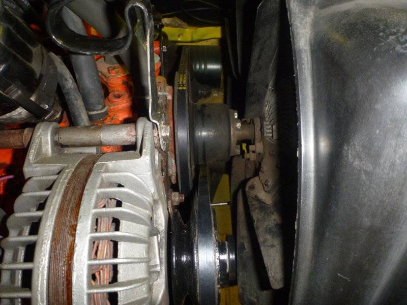

Also discovered my new alternator fan belt likes to flip over at high rev.

As Jeff points out.. a different spacer or some washers between the existing spacer and alternator mounting boss and the block. I did just that before our trip to the Aerowarrior reunion with my Bird. You may need a longer bolt to do so.. check your thread depth.
View attachment 867364 View attachment 867365
Good point on the bolt length...:thumbsup:
