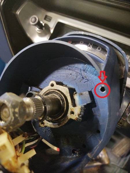

Lost key. Storage building sold. Mother entering Dementia and need to get cars moved out of storage and back to handle some family care ASAP. Thought I had prepped well. Watched several videos about this process and read several forum threads on it. Of course, mine is not working like all the rest. I did read somewhere that 73 charger satellite columns are unique to themselves and one year only.. And perhaps that's why none of the advice I've read or watched online has helped. This is on a 1973 Satellite, AT, column shift and column key. I removed the steering wheel. I've gotten the turn signal switch removed from the column and out of the way. I cannot get the next outer collar to come off of the column so that I can access the next piece of collar that has the actual key switch in it. Every video I've seen shows things coming off rather easily. One guy with a 73 charger did show that there was a c clip holding that collar on. I did remove the rubber seal that blocks the c clip and get the c-clip off. But the bearing that was being held in place behind the c-clip simply will not budge. Does anyone have a schematic, any experience, instructions, or a video showing how to remove this. The car had a very nice original interior and I already did Chip part of the column trying to use pry bars and screwdrivers to nudge that piece of collar off. It simply will not come. Any advice is desperately wanted, begged for, prayed for, and hoped for. Thank you very much. Not sure if this will come through, but I'd gladly give someone my personal phone or email if they could help out. Thanks again!

Chiming in until someone else can, its been 10+ yrs since I messed with mine, so you are warned. I don't remember going further than where you're at now. I remember taking a paper clip and pushing in on the spring that holds the key assembly in place. It's NOT a 'one year only' deal. I *think* its that hole to the right between the two screw holes.

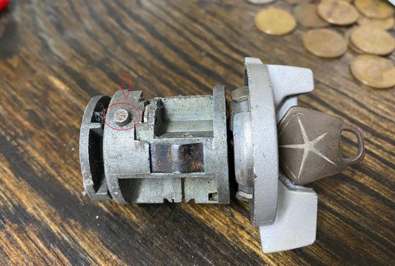

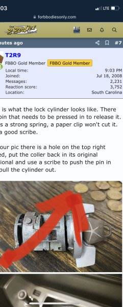

Here is what the lock cylinder looks like. There is a pin that needs to be pressed in to release it. It has a strong spring, a paper clip won't cut it. Use a good scribe.
On your pic there is a hole on the top right circled, put the coller back in its original positional and use a scribe to push the pin in and pull the cylinder out.
View attachment 1316982View attachment 1316983
That is not the hole. The upper housing needs to come off. That hole is for a screw that holds the upper to the lower.
But you have to REMOVE that current piece of column collar to GET to the next step where you actually CAN push the little button and remove the key cylinder. I know how to remove the cylinder itself. I need help getting to that point! And I've read several places that say they should all be the same from '71-'74 or whatever, then watched the videos, and mine is NOT THE SAME. So when I read one place that this IS an oddball set up and year, it is EASY to believe. The question is, HOW DO I REMOVE THAT BEARING IN THE CENTER OF MY PICTURES THAT WILL NOT (LOGICALLY) BUDGE? As I said, the metal column collar has already cracked/broken as opposed to that bearing moving. But thanks for writing. Just clarifying my problem.
This is the most promising thing I've read yet, and was not mentioned ANYWHERE in any of the multitude of threads I've read nor in the videos I've watched. I'll try it in the morning. Fingers crossed and thanks for the input even if I can't get it that way!
