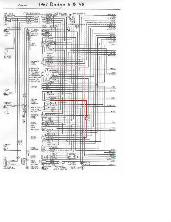

I wanted to give you an update on the electrical problem in the 67 RT that you were coaching me on. As usual been busy with other things but I think I have found the problem and have gained a much better understanding on how the electrical system works on this car. The first thing I discovered is that the wiper motor plug was not wired correctly by the person who restored my variable speed wiper motor. I finally got the wires in the right order and power to the wiper motor. To refresh, the problem we were dealing with was with my ignition voltage which actually increased to 10.6v with key in start position and the correct wiper wire orientation. So I began looking for the missing 2v and noticed what was a intermittent click coming from the flasher switch. Checking out the sound, I first unplugged the unplugged the flasher but the click every 15 or 20 secs remained. When I unplugged the wiper switch, the click that sounded like a quick beat of the flasher stopped. When I checked the wires from the plug, I noticed that the pink power wire was not attached to the connector but I still had power to the wiper motor. That was odd because the wiper motor did work but only on 1 speed. Additionally when I tested for voltage I noticed that I had 12.6v but dropped to 10.6v at the battery when the click sound occurred. Checking further I discovered that the wiper switch was for a 2 speed wiper motor but I have a variable speed wiper installed. What I think was happening is that battery power was being backfed from the ignition switch to the flasher and the wiper when switched on. I have a variable speed wiper switch on order and I believe when I get it installed and everything wired correctly, I will finally get my 12+v to the distributor. Regards, Carl
I have marked up the wiring diagrams to what you have traced out, you can see power comes from the fuse box to a 4 way splice with one to the ignition and one to the flasher and one to the wiper. Hope this helps study it closely.
