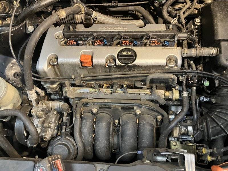

Lookie what I just found.
Intake cover with “I-VTEC” label.
Two nuts to remove.
Then….

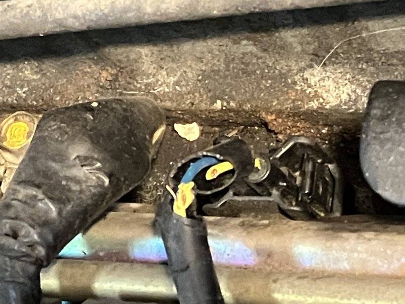

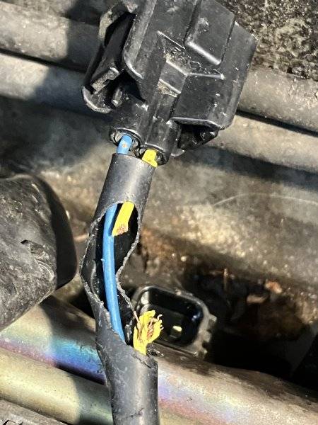

#3 injector.
Hmmm.
I’ll solder in another yellow wire so they match and report back.

Nice find. I’m surprised that it had no injector code. But model to model and as years go by, the diagnostic codes and code sensitivity changes. But happy to see an obvious fault.
Good news.
The shoddy, temporary repair worked. The engine idled normally, no codes came up and it seems to idle in gear as smooth as before.
I’m going to go back to the junkyard and cut out a longer section of injector wiring and solder that in.
It is strange that one failing cylinder affected the others.
Good news.
maybe 1 and 3 share that yellow wire......... congrats, that's the **** that'll make you crazy
