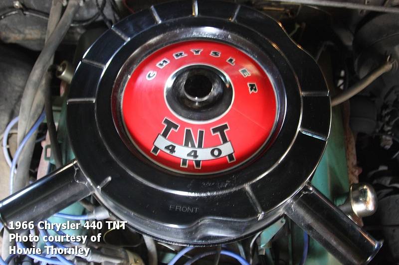

1966 440 TNT my Moparmate has just got one over from Texas.
What was TNT supposed to mean?
Trinitrotoluene is a bit of a mouthful...
