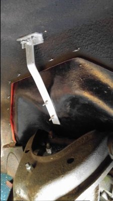

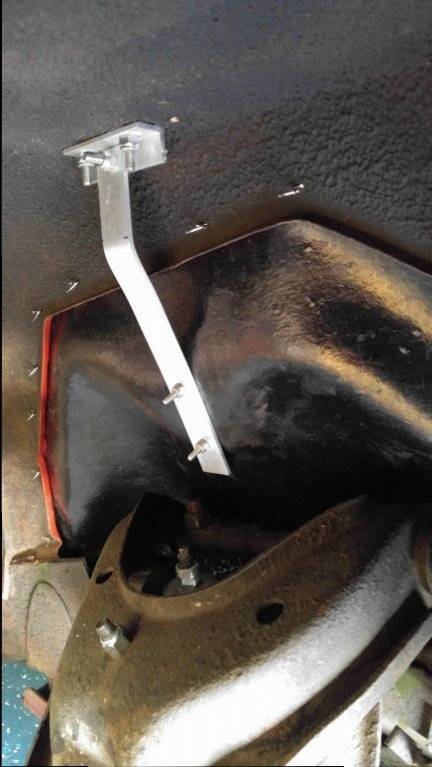

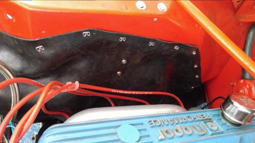

On a side note, i made a small bracket for my fender splash guard. It kept wanting to pop inward towards the engine and touch the header,so i rigged this little bracket to keep it pulled outwards. Some aluminum, SS hardware, and using preexisting holes made this work out great and simple!

Nice, mine had a tear in it but otherwise was quite usable so I did.
