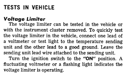

Actually I don't think grounding the sending unit too long would damage the Voltage limiter rather it would just destroy the gauge. It's possible but not real likely.
See if you have 12Volts to the limiter first if you don't have that then none of the gauges will work just as you've described.
You can easily test the limiter outside the vehicle.
Gotta remember Greg that the "gauges" are just volt meters. They get + power from the IVR (when the key is on) and ground via the the sender. Why grounding the sender wire = a full gauge sweep. You sure you grounded it and didn't put the sender wire on the + terminal..

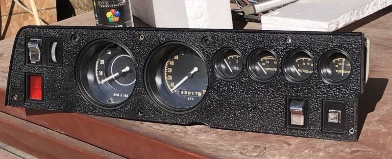

Jigsaw had functional gauges since the moment I got it running and driving. I went through the instrument cluster to get it working but to retain the "seasoned" appearance until I actually restore the car. They looked bad when I got the car in September 2019...
They look less bad now.

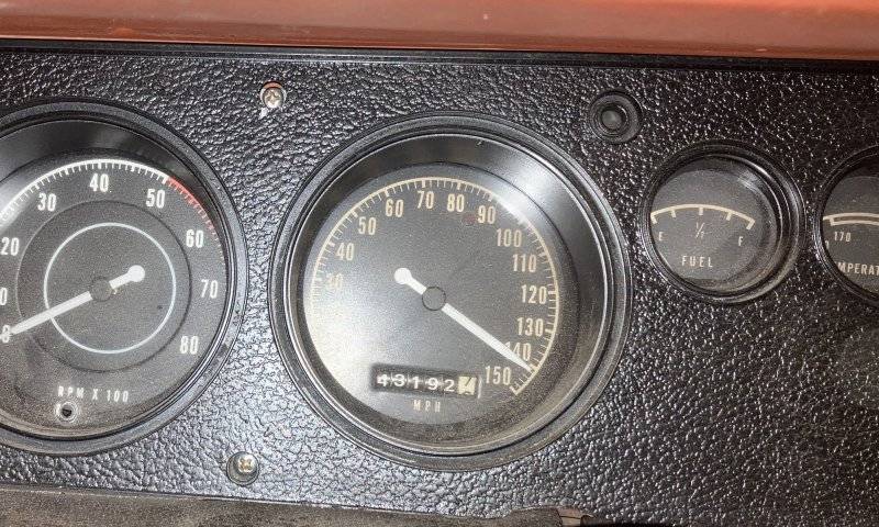

I did have to have the speedometer rebuilt when it decided to stick at this reading:
As I stated, the ammeter still works but I forgot to mention that the tachometer hovers around 1000 rpm and barely moves when the engine speeds up. The tach is an aftermarket thing...Remember "Charger Specialties" out of Idaho? Back in 2001 I bought it....they took stock clocks and reface them with a tachometer that almost looks like it could have been original.
