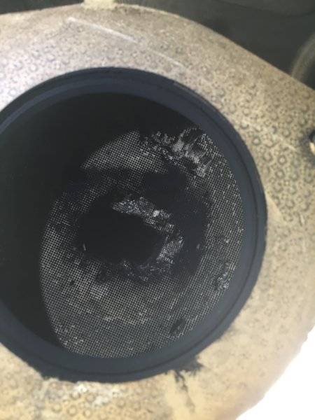

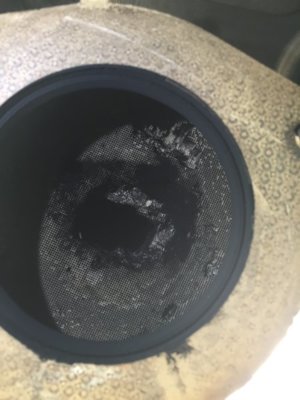

Went to take off the DPF filter to clean it and look at this ****! The same with the NOX filter. The place I bought the truck from is trying to locate a good used set for me, we will see as I’m not gonna hold my breath.
1F917F85-6271-4EBE-A1D6-F6B887BE8394.jpeg 406D98CC-56BB-4F7C-A05D-465AA9E6D992.jpeg
Update.....the hole in the wall dealer came through with a used set of nox/dpf filters. They want the old stuff back (not feeling that due to the **** I’ve been through buying this truck). Anyway, had to have the injectors programmed into my new (vin flashed) ECU. Got that done, now to get the I/M Readiness monitors to go green. California allows for 2 to not be ready and everything I read said it could take up to 1200 miles. WTF!!!
