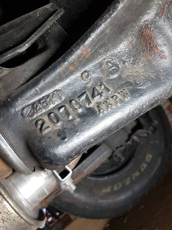

Hi i have a 440 6 pack in my 69 coronet. not a original setup, i think it had a 318 in it previous.
I wanna know if this diff will be able to hold up with the setup i have now or will i have to upgrade to something stronger

i was just worried because the info that i have found says its for the 6 cylinders or small v8s being the 741 case.
The 741 casting uses a smaller pinion gear and u-joints, yes it's what the factory used for some /6s & the lo-po v8 cars...it can live with your setup, but it's generally not recommended...you're going to be making lots of torque, the best long-term solution is find a 742 or 489, all the cases interchange with the housing & axles on the 8-3/4

Yeah thats what i was worried about. Especially since i live in Australia, finding something like that gets hard.
For a street car with limited traction the 741 probably works OK for a while. If you get traction with a big block it won't last very long especially in a heavy car. The bigger pinion (489 or 742) setups are much stronger. Chrysler knew what they were doing back in the day with big blocks. Many of the 6 Paks (4 spd or auto) came with the "Super Trak Pak" Dana 60 rear axle. That is probably overkill for a street mild 440.

I think your current rear end is just fine & should last a long time. If you do go with a different center section, I think your existing axles will fit. However, I just heard something about spline count on '70 & up or something like that being different ???? So, I guess double check that. Someone else here probably knows for sure. Your axles will be the correct length for sure.
Input yoke spline is different, axles same. 7 1/4 is the weak rear end, not the 8 3/4.
