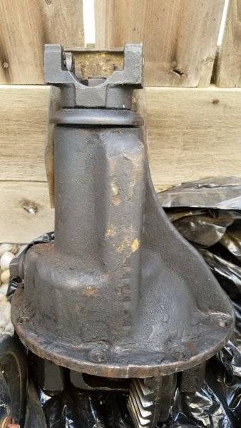

The engine and driveline all the way back are offset to the passenger side about 1-1/2" give or take. Where this offset is corrected is in the carrier of the 8-3/4... The pinion shaft is offset enabling the axle housing to be centered, and the axles to be the same length... Not that Chrysler couldn't have installed it a little wonky but your wheels should be in the same spot on both sides or at least really really close... if you don't mind the little rubbing and it's not causing other problems you can probably leave it be, otherwise it may warrant further investigation.
Here's a center section from a '68 8-3/4, to show the offset.. your 66 should be the same
Is the bearing adjuster on rubbing side or other

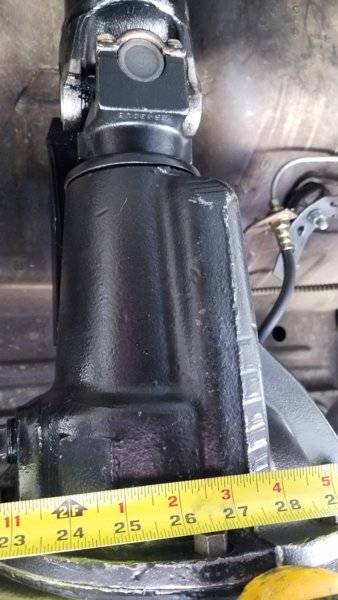

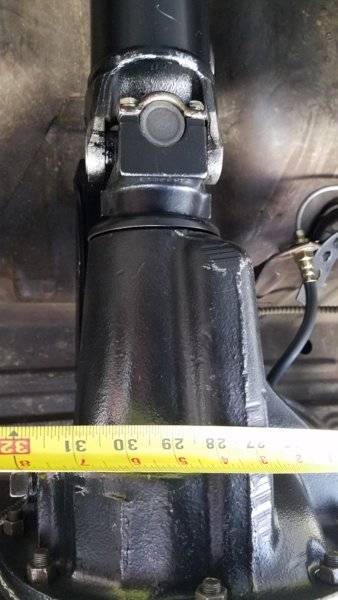

All measurements taken from the inside edge of the axle housing flanges-'68 B body
-from the driver side flange
-from the pass. side flange
--Measurement from either side to center of housing is 27-1/4"
