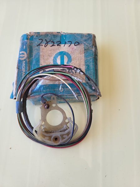

I have an nos 66 switch ( not with me at the moment , and is not for sale ) But no idea what the differense is for the 2

As the search goes by, I am pretty sure that it is the switch that have the problem. I have a spare 66 switch. I hope that it will help me out. Just great to know that they have similar functions and no obvious differences.
