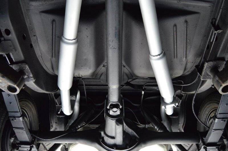

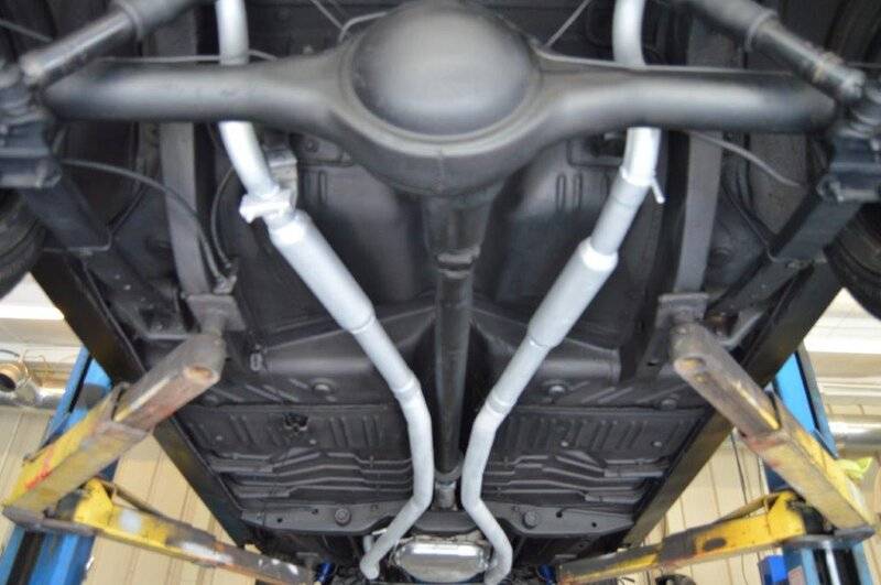

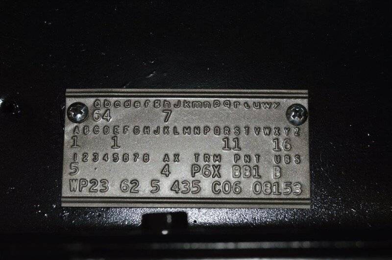

I’ve put down a deposit on a 67 Coronet 500, with a 383 - 4 barrel automatic. The fender tag indicates that the gear ratio is 3.23, but it does not seem to indicate that a sure grip was installed. I’m trying to identify the rear axle based on a couple of photographs and I was hoping someone could help.
View attachment 1214089 View attachment 1214090 View attachment 1214091
8 3/4...........Don't know the code for a Sure Grip but you can turn one wheel and the other should turn in the same direction. It's even better to have someone or something hold one wheel and they try to turn the other. If it has resistance, it's probably a SG or rusted inside. The resistance is high....

Thanks for the info Cranky. I read that X8 is the code for a Sure Grip. How difficult/costly would a swap be if it turns out to be an open differential?
It's not hard to swap them out but just have to make sure you get the back lash the same as it was before pulling out the open diff....the cost depends on if you get the cone style or the clutch style. Over the years, I've been able to make the cone units work well.
