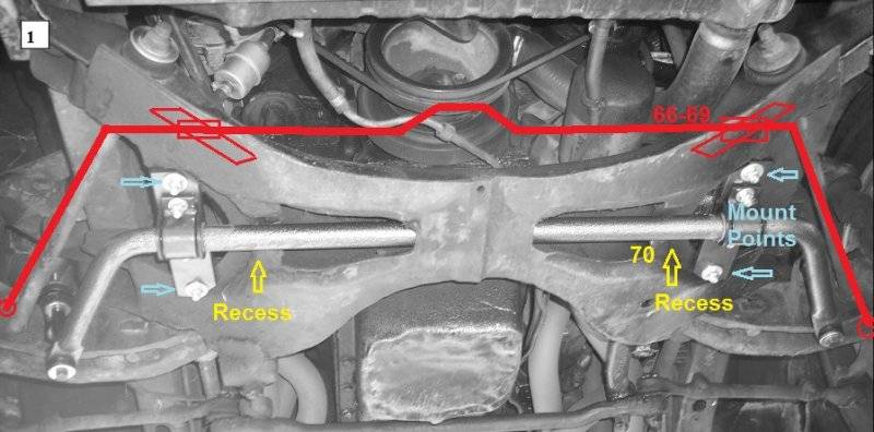

But the most notable thing about your sway is that it is installed upside-down - the "hump" goes up, not down (should be above the k-to-radiator brace). That's why only one bolt of your k-frame bushing mount brackets "hit" for each one. The way it faces probably doesn't matter much...but a bolt to nothing sure seems that it would?

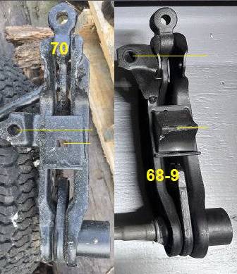

K-frame: What are the bushing brackets for in the 1970 K-frame? Still learning, thanks
Sway Bar: I bought the car on 2025-01-16. I did not install sway bar. I agree about it being up-side-down. Another item for the to-do list.

...bushing brackets for in the 1970 K-frame?
Different shape, length and all mounting points. I concocted a reference sketch on an image lifted from an aftermarket (Hellwig?) that's pretty much the same as stock. (I am grate artiste... LOL -NOT)
Edit to add a tidbit:
Images lifted from others' threads on here showing lower control arms' sway bar tabs relative positions for the two different vintages.
