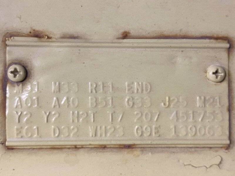

I am following @3x2bee thread about a 6 pack transmission and seeing there is distinction between the 6 pack / hemi 727 and the HP 440 727 and was wondering about my 69 Coronet 440 with a 383-2 bbl engine that has an HD 727 ( code D32 )
What makes a HD 727 better than a standard 727 and would it be the same as an HP 440 - 727 ?
Code D32 does not mean HD 727.
a 383 2bbl trans is just about the same as a 318 trans inside. 3 disc front clutch, 3 pinion planetaries. Low up shift governor.
Ok now I am confused as the decoders said that it was a 3 Speed Auto Heavy Duty.
Here are 3 that I used. Not saying they are correct by any means but was wanting to confirm.
http://www.passion4mopars.com/1969-1971-Fender-Tag-Codes_b_25.html
https://www.stockmopar.com/mopar-fe...E&Vin3=139063&vin=WH23G9E139063&Submit=Decode
https://www.mopar1.us/6971codes.html
The H.D. 727 has 4 pinion planetaries, front and back. Also 4 clutch drums, front and back (Hemi trans has 5 clutch drum and wider kick down band). These transmissions also had different spring pack in the front clutch than regular 727. The governor assembly had lighter weight and spring for higher upshifts. They usually had 3.8 ratio kick down lever instead of 2.9 or 3.2.
Any 727 is capable of holding 700 HP. a 4 disc high clutch, a good valve body, a deep pan will get you there. The only real differences are 3 to 4 pin planets (not needed), governor and valve body calibration, kick down lever ratio, and number of clutch and servo springs.
