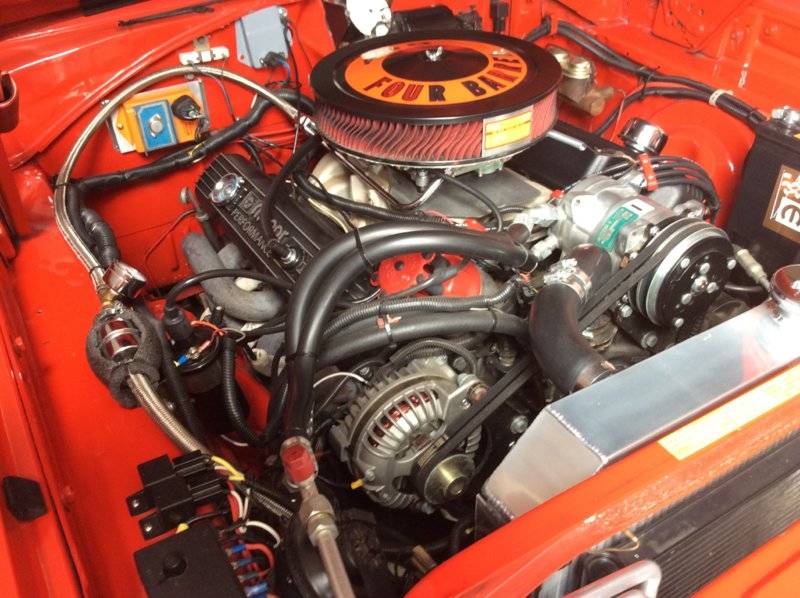

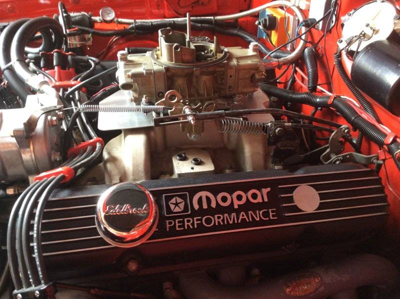

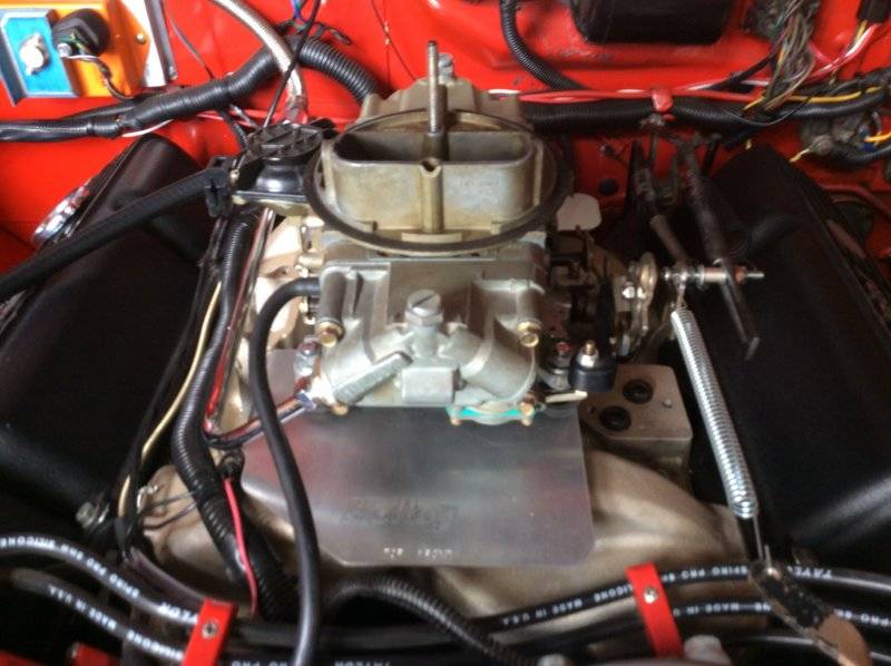

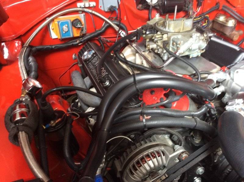

I to am in so cal, had to insulate everything to lower fuel temp in engine bay. Reroute fuel line insulate fuel line, heat shield, thermo spacer, and put insulation on bottom of air cleaner with aluminum shells. Here are some pics of what I did . Works very well.
