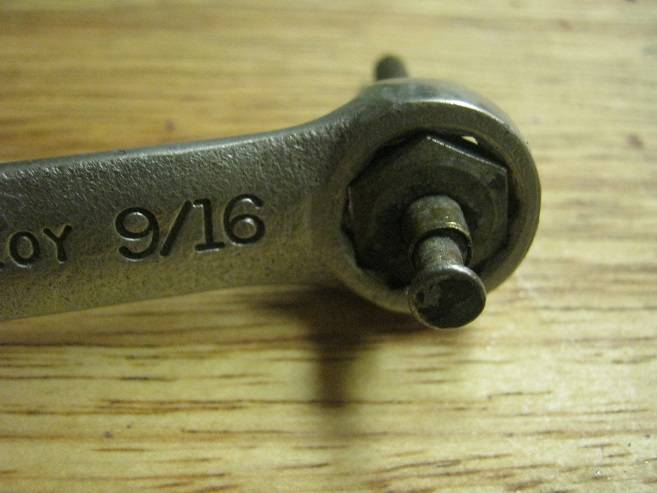

I remove my 74 door jam switches with 9/16 hex wrench as far I recall, so... I guess this mean my car is 1/2" thread hole ? I know several changes were made by Mopar by those years, soooo this can be confusing and just need to try to match your assembly

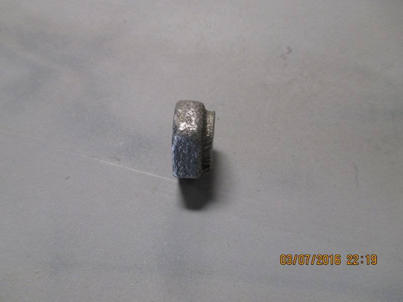

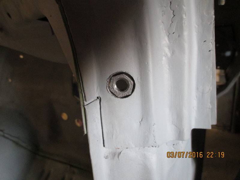

No one makes the larger door switches 1/4 pipe tap. You can however get them with the smaller 1/8 pipe tap. What I did was use a pipe reducer 1/4 outside and 1/8 inside. I cut off the 1/4 threads and was left with a hex head with 1/8 pipe threads inside. I drilled out the door jam switch hole so that the reducer would fit inside and welded it in. Now you can use the smaller door jam switches.

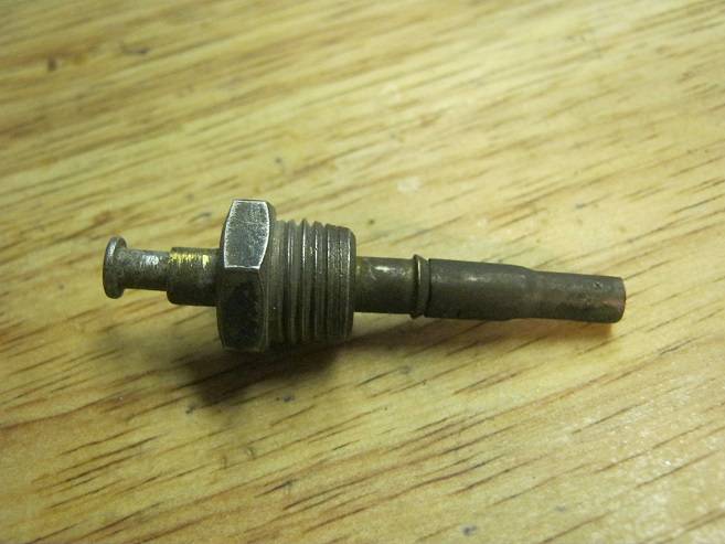

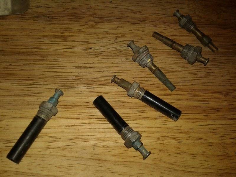

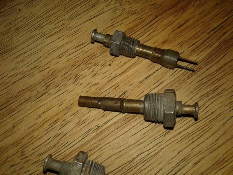

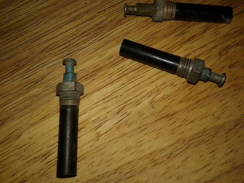

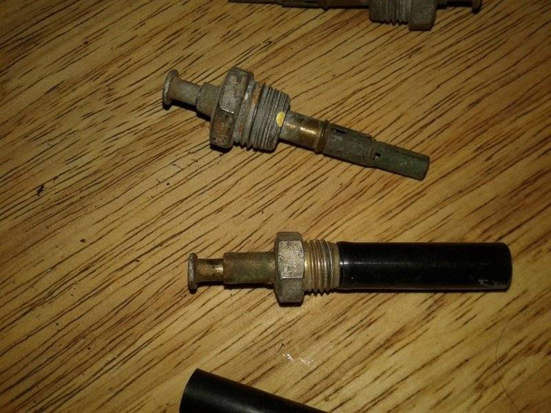

I have these if you're wanting OEM. Looks like I have 2 large diameter ones, both with single connectors. One double connector with small diameter and 3 single connectors with small diameter and sheaths over them.
20190213_195402.jpg 20190213_195408.jpg 20190213_195413.jpg 20190213_195416.jpg
They will fit and could work for passenger side ( diff terminal thought at least on mine ), but drivers needs at least two prongs as minimun to be able to get the warning buzzers working just with driver side door. Using single terminal on driver side and splicing blacks and yellows together will make the warning buzzers work with passenger side too.
