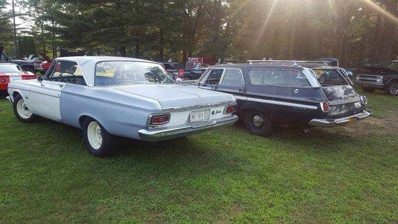

Wagon getting the later rear from the 2 door slant 6 car, as well as the big meats.
Keeping the 2:76 Sure-Grip from the wagon.
