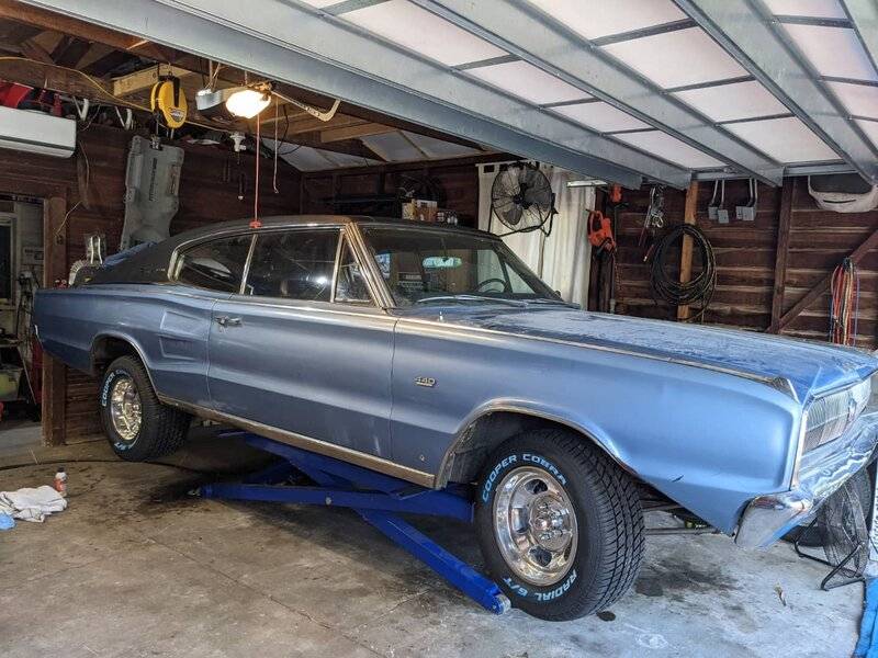

By waking up the 67 I meant it had been parked for 27 years. It's got the 440 it came with and I hadn't planned on doing too much more than wheels, tires, brakes and fuel system. All mostly done.
I'm going to try to avoid trans or diff rebuilds for now, both are things I'm not much ready for. Just seeing what I'm in for later and what a good course might be later.
By waking up the 67 I meant it had been parked for 27 years. It's got the 440 it came with and I hadn't planned on doing too much more than wheels, tires, brakes and fuel system. All mostly done.View attachment 1188674

I would also change ALL the fluids too. 27 years is a long sleep. Was everything working ok when parked?
Well understood, and yes; cylinders were lubed before cranking, oil has been changed, coolant flushed, yada yada. It was a ran-when-parked situation by the PO, a friend I'm still in contact with though a couple thousand miles distant.
This was the first time I've dealt with a car in this condition, so I researched it pretty heavily. On the upside it's in pretty darn good condition other than having sat for so long.
That car looks great. If you have to change diff fluid anyway you could try that cone style suregrip on the current gearset that is in the car. I would recommend new side bearings though. It's a pretty easy changeover, but you need a dial indicator to check backlash before and after the sure grip install.
