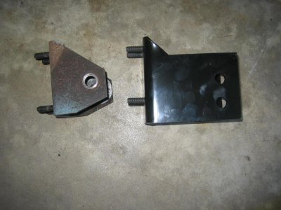

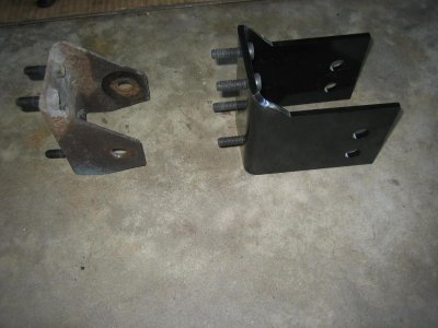

OK - let's try this. Sorry if they're really big. The first pic shows the car with the stock springs. The others show the comparisson between the stock and extended front hangers. The last pic shows the car with the SS springs and the vibration. Notice that I had them bolted through the lower hole - this is the highest option.

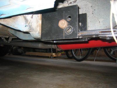

Here is another pic that shows the mounting holes. I don't have a pic of the hangers with the new holes, but there's now a hole 3/4" forward and in the middle of the two holes they came with. This is the hole that the front eye is bolted to now.

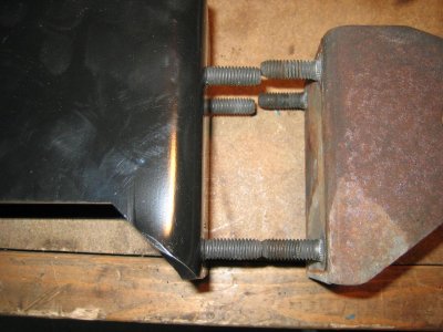

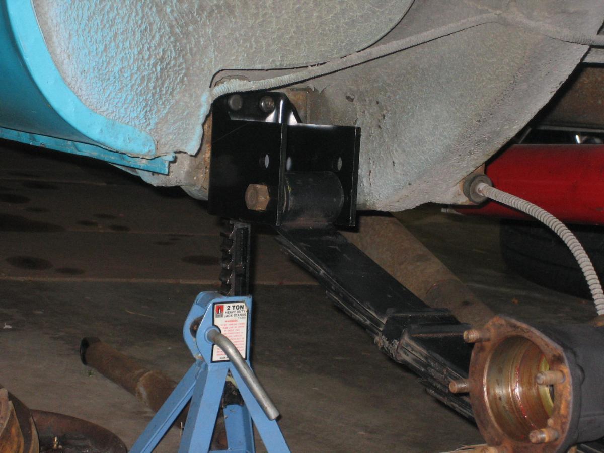

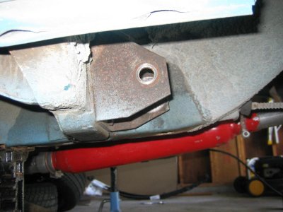

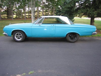

The second pic shows how the 2" hanger studs didn't exactly match the factory studs. A little reaming of the body holes was necessary to get them to fit. The third pic shows the car as it is now. The torsion bars are cranked up a bit, and the pic has a shadow that obscures the view of the rear wheel somewhat. I don't have a better pic at the moment (too late to take one tonight yet!).
