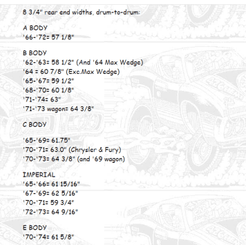

I have a few B bodies from 68-70 with Dana 60s in them, I am looking at a 72 Road Runner project and was wondering if the differential (rear end) is the same width or different?

The differential is the center section. The axle housing is the concern. The 68-70 B unit is narrower by several inches. You'd have to relocate the spring pads and even then, it may be a tight fit. You'd need wheels with much more offset to avoid rubbing the leaf springs.
E body is pretty close, but a bit more narrow than 71-74 B.
From a once great website:
Think there's a sticky on actual widths over in FABBO.
