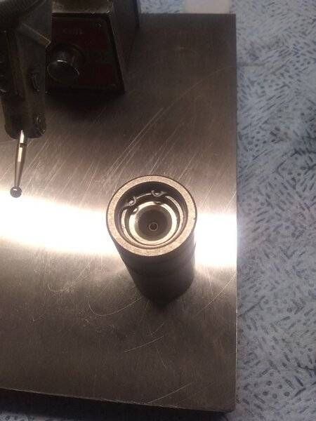

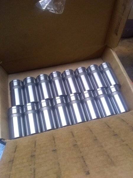

I bought a whole cam kit from Lunati, hydraulic flat tappet.
I inspected the lifters this morning
15 good ones,
1 mics .9025, the factory spec is .9035-.9040.
It also has a diagonal gouge from the grinding wheel.
I'm not sure if I should use this.
Also some of the rattle when you shake them, others don't.

I did take one apart. There is no ball bearing.
They all got to rattling after I shook them up good.

The Rhoads lifters I got all check in spec.
The bottom corner break is more uniform and smoother.
