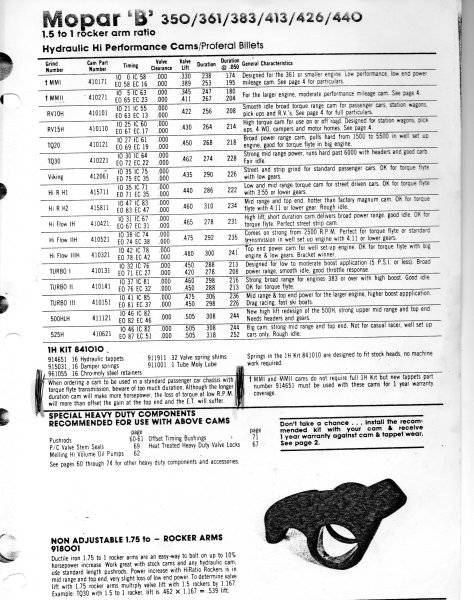

If you want more idle vacuum, change to a cam that is a single pattern with about 220* @ 050 such bas an Isky 270 Mega.
BB Chrys do NOT tolerate a lot of duration because of the high rod/stroke ratio, see below.
Also, you will need a LOT of timing at idle, with either cam; if you keep the current cam, you may need as much as 35* at idle. Yes 35* !!!! Maybe more. Easiest way to do this is using vac adv connected to manifold vacuum. Choose, say 15* initial & add 20* with vac adv. See below
