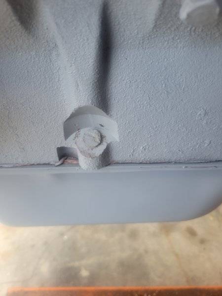

Has anyone ever seen this? It appears that a metal plug has been inserted into the dipstick hole.
Remove the pan and tap out with a punch. Dodge pickups used them because the dipstick bolted into a fitting in the side of the oil pan.
Possible motorhome or truck block. They run the dipstick on the side of the oil pan.
I got it out by drilling a small hole half way through and screwing in a sheet metal screw and yanking it out.

I have mine tapped with a pipe plug on my block. I run Moroso 4 vane vacuum pump.

Drilling and screwing a hole, ok, but yanking it out ?

That's the ultra-rare, Mopar, dip stick delete option!
Hang on to the plug, there's guys out there that need them for their 440 truck install
