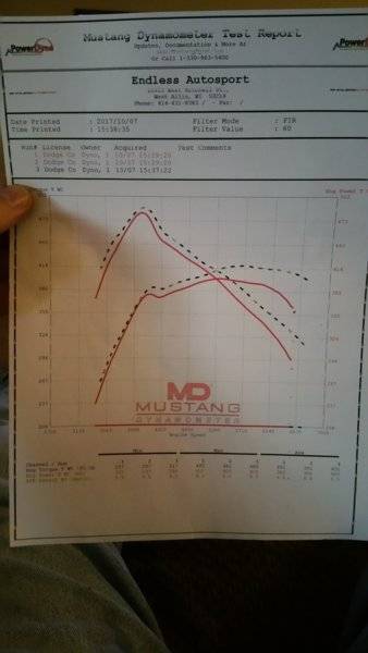

Hopefully someone can make me feel better. I took the Coronet to a dyno days event with the new combo and numbers were WAY below what I would have expected (see photo for dyno sheet). The motor in question is my 526" (4.375 x 4.375).
My combo is as follows:
10.78:1 cr
Custom ground 262/269@.050 .715 lift Solid roller bullet cam
TF 270's (ported by Larry Smith - see flow sheet)
Indy 4150 max wedge port single plane intake (also ported by Larry)
850 mighty demon carburetor (factory jetting with 35PV)
Ultimate 8.5" 3800 stall converter just built by Lenny for my combo.
I know I am handicapping the combo with the carb but I did not expect the numbers to be that low. No way would I ever have expected the max torque to be less than 500 ft. Lbs.
The dyno guys said the numbers are low due to the converter and the dyno can't accurately reflect the true numbers because of the high stall. I watched several other vehicles that I know weren't as built as mine laying down better numbers. Can someone educate me on where they think the problem is? I will run a compression check tomorrow to make sure everything is sealing but I don't think that is the issue. I am also surprised by how low the torque peak occurs.

Pretty hard to see your chart. Chassis dyno's are affected by a lot of things. They are better suited for tuning than pulling big numbers. Take it to the track and see what kind of et/mph it pulls. That'll tell a better story. I will say an out of the box carb probably isn't optimal. If money is tight, throw a bigger main body at your carb.

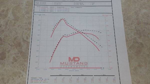

It will get a bigger carb over winter. I ran out of money this year. I still have to order the dana so the rear end won't blow up on me next year. That is the last big purchase until spring. Here is a better pic. But all it made was 418 hp@5600 and dropped from there. Torque was even worse. 489 ft. Lbs. @ 4100 and dropped from there.

418rwhp @ 5600rpm? Something is seriously wrong here. That engine combination should be upwards of 675-700 fwhp. Dynograph looks as if the engine is starving for air. Throttle plates in carb opening 100%?

It almost seems like you're down a cylinder. Car should easily make 500rwhp on its worst day, even on a mustang dyno. Graph seems accurate, spread is correct between peaks. I'm just surprised the torque peak is so low (which is why the results are disappointing), even with 526ci, should be at least 750-1000 rpm higher (I would imagine). 380 cfm of airflow @ .700 lift, something is SERIOUSLY wrong here for it to have a torque peak @ 4100 rpm with max-wedge port heads. Converter seems way off for this combination.
