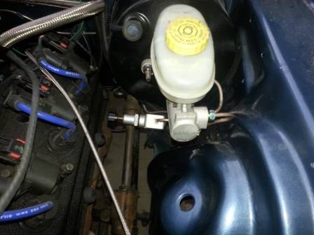

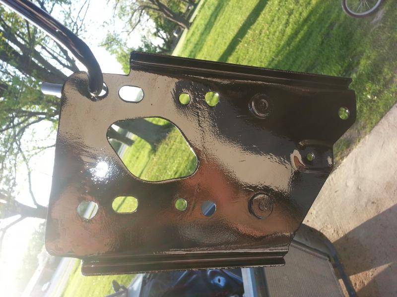

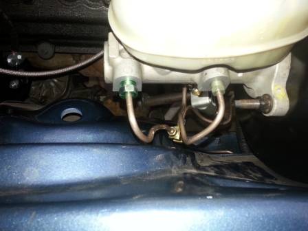

Well I never detailed out the installation but I basically set it right though the existing hole in the firewall and marked the holes that needed to be there for the bolts, drilled the holes on both that and the mounting plate, added about 1" of steel to the lower part of the plate to accommodate the lower holes and bolted it in. The pedal needed a small amount of steel welded to the back and a new hole drilled to hook to the new booster but nothing real special, to measure that i just held the pedal where it needed to be and used a tape measure, welded it on, then put it back together and held the pedal again to mark the hole, drilled and used a grade 8 bolt for the pin. That was it and it stops great. If you are keeping existing brake lines you will have to run new ones from the proportioning block to the master cylinder though, for the cherokee master the front brakes use an M12x1.00 and the rear is an M10x1.00 both bubble flare.
From the pictures you can see the extra holes in both the firewall and plate. The plate is hanging from one of the new holes. There is about 1/4" to 1/8" of space between the booster and inner fender, so don't get anything larger than this. I also redid my brake lines (needed to anyway) with all new and added a summit racing rear proportioning valve to work with my rear disk package that I built.
Depending on how "performance" oriented you want to be depends on what I will recommend, if you plan to take it to track days and tear up the track then I'd tell you to invest in an Alterktion and add big dual piston discs to it with slotted rotors. If you are like me and want a dependable street driver that will stop just as well as a late model then I say run the A body brakes with a late model booster/master and maybe upgrade to rear disk (but rear drum is still ok here).
