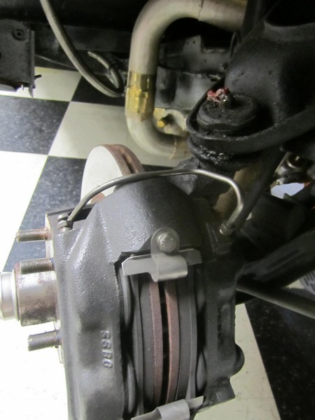

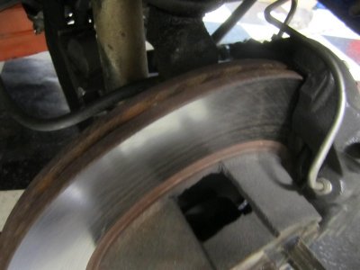

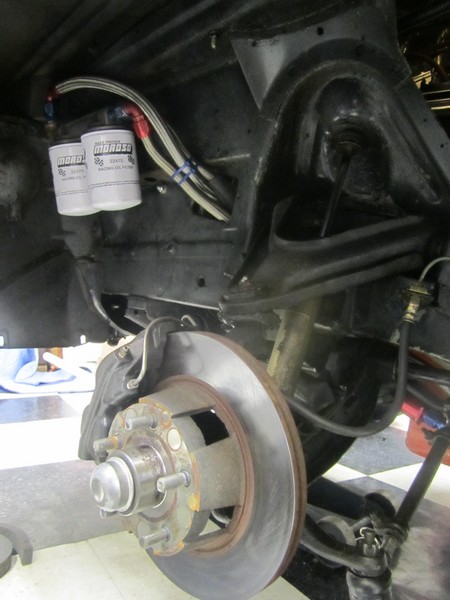

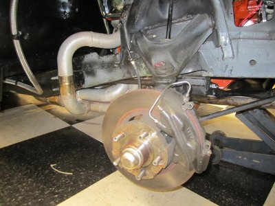

When I did my '63 years back,I wanted an updated/new caliper.I was between SSBC,Wildwood & Bear.I felt the SSBC kit that fit my exsisting spindle was the best deal knowing I would eventually be hitting 150 MPH in the 1/4 mile.The SSBC caliper is a 4 piston NEW caliper. I'm sure the "A" body swap is ok for a street car,but if your trap speed will be over 120 MPH I feel you need a better set up.
