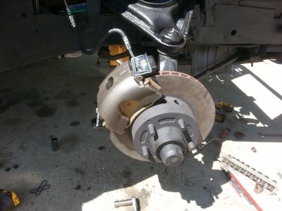

I took the spindles and 11.75 in brakes off a 78 cordoba. Paid 25 bucks for them at a pick and pull. They are the slider type mounted in front of rotor. I used the brake hoses from a 1980 St. Regis. They went on like they belonged there.

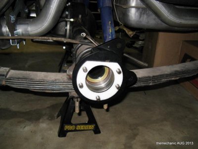

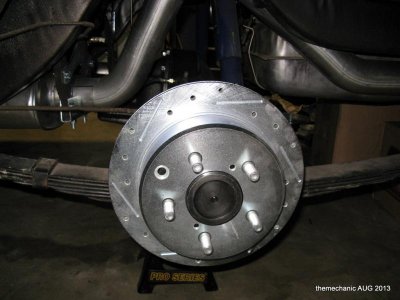

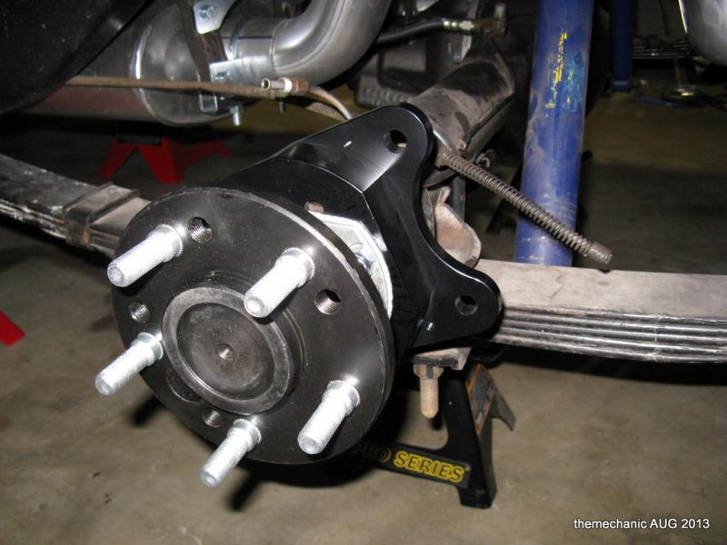

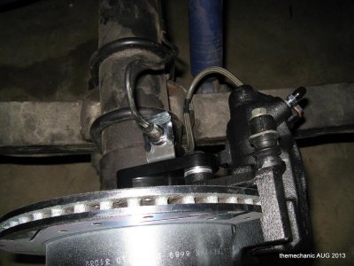

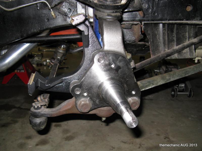

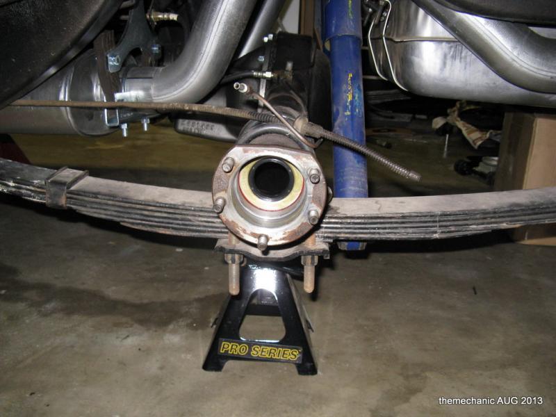

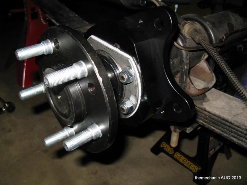

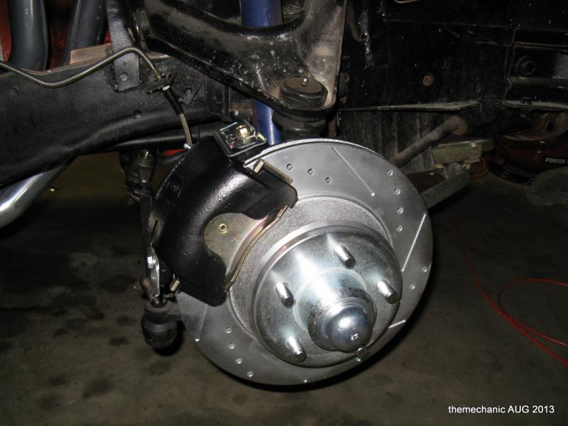

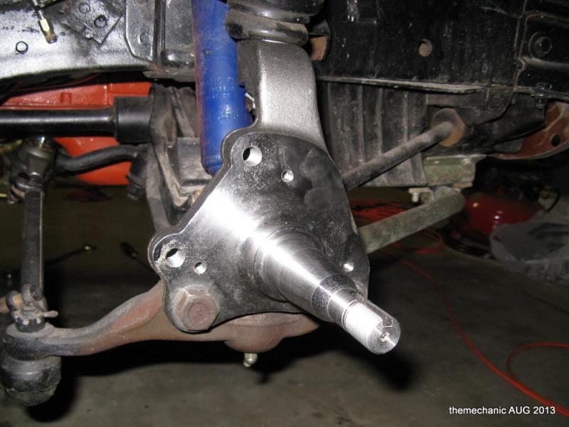

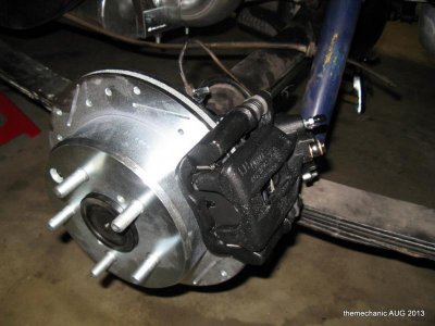

FRONT with sway bar/ rear mount caliper
REAR
Rear drum to disc conversion.jpgRear drum to disc conversion-001.jpgRear drum to disc conversion-002.jpgRear drum to disc conversion-003.jpgRear drum to disc conversion-004.jpgRear drum to disc conversion-005.jpgRear drum to disc conversion-006.jpg
