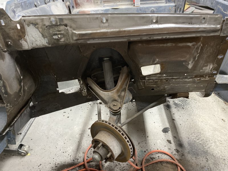

are there 14 inch rims that fit disk brake conversion on 63 Plymouths?
Do you have disc brakes now. What does their specs say. If not, Disco Tech article says you can put 14" over the 10.5" rotor. I don't know if that applies to all 14" wheels.
14" Mopar rally wheels, and newer, post '67 steel wheels should fit over early factory disc set ups ? I know we have them on our '73 Duster.
However, the original 14 & 15" early steel wheels, pre '65, that accept the 10" dogdish caps will Not fit over the calipers, without using a spacer. This may not apply to what you may be using ?
14" wheels that came off a disc brake car is what you need.
I’ll try the seventies rims. Thanks to all and will update when i try them.
Here's Dr. Diff's Stage 1 kit. Scroll down and read the description about what wheels to use.
