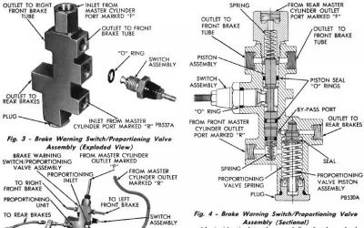

I'm trying to get new lines from the master cylinder to the dist block, T off the front lines and add a proportioning valve to the rear brakes,thus eliminating the dist block all together. But I cant seem to find anywhere that has the sizes listed for the dist block. In this pic on the left you can see what I'm talking about.
My only guess is it's a 1/2-20 coming in to the fronts, then 3/8-24 to the front lines, and on the rear it's a 9/16-24? to a 7/16-?
Does anyone know!?
