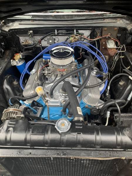

I am pulling my hair out. My LA 360 is up and running. For some insane reason, I can't stop the oil from leaking from the distributor. I put on a new o-ring. Nope. A new metal gasket seal. Nope. Tried a gasket, Fel Pro 6464. Nope. I even put in another distributor. Nope. Should I try doubling up on the felpro gaskets? I just can't stop it from leaking. Oil pressure is high because of the high volume oil pump. Around 100 psi. Any ideas?

It is an aftermarket aluminum intake but it's not touching it. It's an MP electronic ignition distributor. One thing I did notice (a long shot) it looks like some of the gasket sealer has a little extra bead that is close to it.
At idle, it's fine. The minute I drive it, it's leaking.
My bets it not the distributor thats leaking. Its most likely the intake seal or a oil sender.
Are you sure it's not the pressure guage fitting? It is in very close proximity to the distributor. If it is a plastic line to an aftermarket guage they need a new ferrule everytime they come apart.

It doesn't look like it's coming from the pressure sender. It looks dry. Also it's electric so no oil lines. I look with a light and all around the distributor is oil.

Update. Since I have a Bosch oil pressure gauge, the factory sending unit wasn't calibrated properly. I bought a Bosch sending unit and now I'm getting around 50-60 psi. Much better.
I also talked to my buddy that put the engine together. He's going to redo the intake gasket for me next week.

No PCV. Just a breather. When I tried to set one up on the aluminum valve cover, it didn't seat correctly and had a major vacuum leak. I've run with no PCV in the past and never had this issue. The passenger side valve cover has no breather, just the drivers side. Should I put one on the passenger side as well?

If you can see on the drivers side, I had to take the breather hose off the carb and let it hang down. The breather cap had a major vacuum leak so I put a plug on the carb. The passenger side has the regular twist on oil cap.

That is very wrong. You need to correctly get either a PCV and vent correctly set up or some type of vent system. The way you have it is most likely why your rear intake seal failed.

So I may have to pull the passenger valve cover and get a breather cap also?
Tim you need a pcv on one side and a breather on the other to get the pressure out.
As it's set up now you have your breather hooked to manifold vac.
it needs to pull inbound air , and can dbl. As a oil fill point.
the other cover needs to have a pcv .
