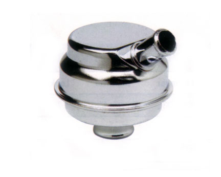

It looks like you have a solid plug on the passenger valve cover. Try one of these in there, you can run a hose from it to the bottom side of your air cleaner. Make sure the PCV is working, if you shake it does it rattle? You sure have classic symptoms of too much crankcase pressure. You will also need a rubber grommet to put this in.

If your air cleaner doesn't have a hose connection to run to this type of breather, there are several style of breathers available with an open type of element that will work just fine.

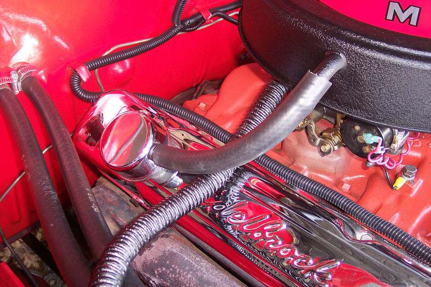

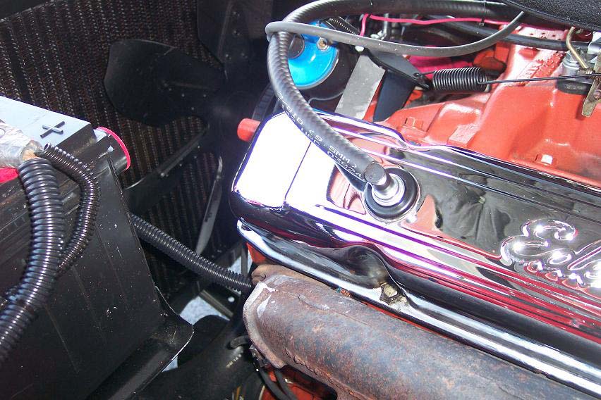

I have 2 photos one of each valve cover; 1 w/the PCV the other of the chrome oil cap.

You have a Prestolite distributor and those take the flat gasket. If the gasket is compressing when you tighten it then should be no problem. My guess, like others said, is the corner of the valley pan may be the culprit, and if you are building crankcase pressure then the problem just gets worse. What you show in the pic above looks 100% correct and if you indeed have two holes in your valve covers then you can't have any crankcase pressure! Check those aftermarket grommets and make sure the bottoms are cut open to allow the gases to come out. Some of them come sealed but the PCV and breather will still plug in.

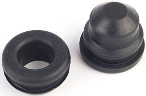

Look at the two grommets. The one on the right has no hole and will act like a plug if you don't cut the bottom out. Or better yet slice a window in the side so it can act like an oil baffle. Because it's longer than a basic grommet it is possible to push the breather in and think all is well. Just something to check.
