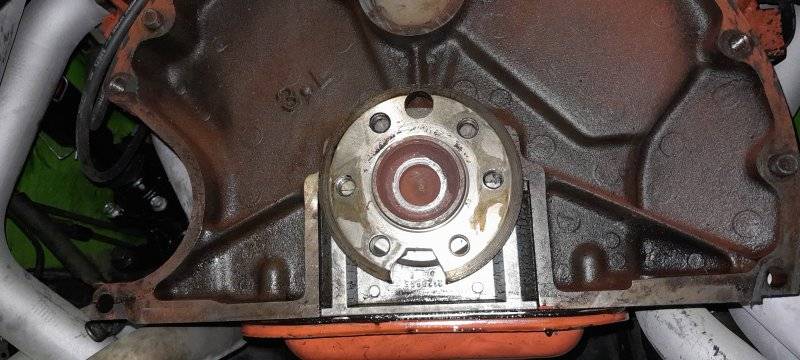

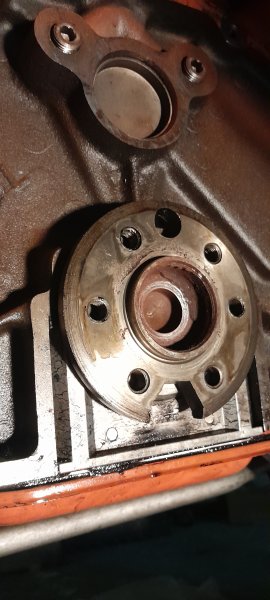

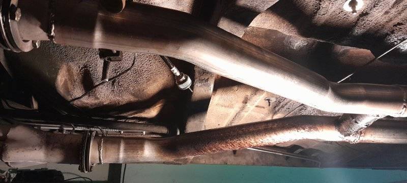

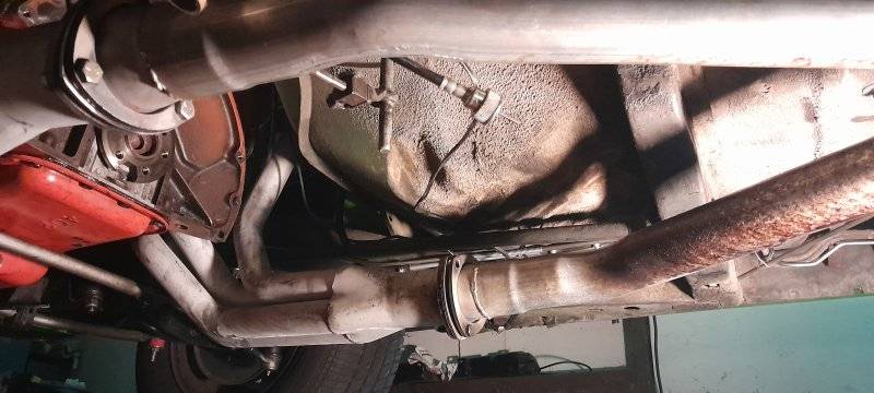

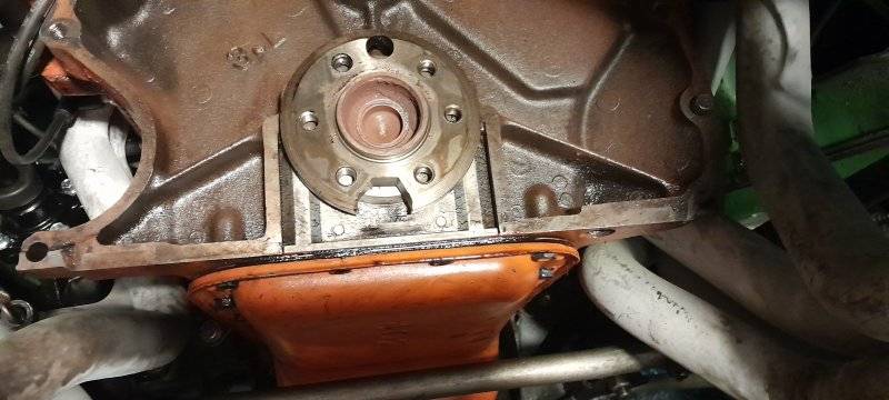

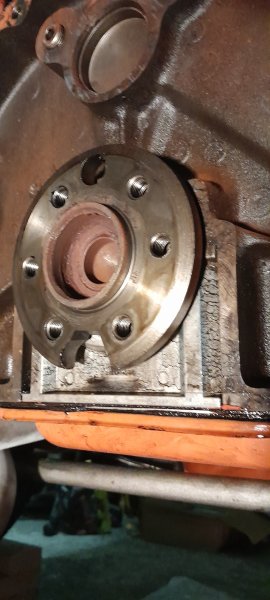

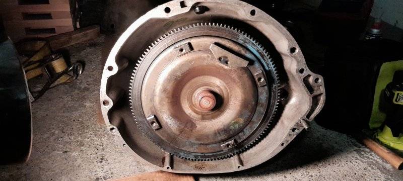

I expected more of a mess after a couple years. Exhaust is really mess BEHIND the trans. It leaks oil, not trans fluid at all. I stay within an hour of the house because of the amount of oil I lose. Drips right from where trans and engine butt up in the center when parked but stops eventually. Seems to only do it when driving and gets blown all over the underneath I have more than great oil pressure and wonder if that has anything to do with it. It doesnt leak from the oil pressure sending unit, intake is sealed.....Blowing out the back corners of valve cover gaskets? Or is the seal obvious (never dealt with one)? I did wipe the bottom of the oil pan and center link off but there wasnt much oil on them. Thoughts? Ideas?
To me (I’m no expert) your rear seal is fine but it’s possible the seal retainer is leaking, maybe at the side seals. If the rear seal itself is leaking I believe you will find oil slung all around in the bell housing from being spun off by the crank and flywheel flange. To me your inside of bell housing doesn’t look dirty and oily enough for a rear seal leak of that magnitude. Unless it really leaks a lot but hasn’t been doing it long enough to plaster down a bunch of dirt and grit. Or am I mis-reading your pictures?
If the seal retainer leaks it just gravity-seeps out and down until it hits the slip stream and then back along the outside of the bell housing, transmission and on to your exhaust. However, don’t rule out possibly having a leaking valve cover, leaking intake manifold leak at the rear China wall or an oil pan leak (or some combination). Just my guess.

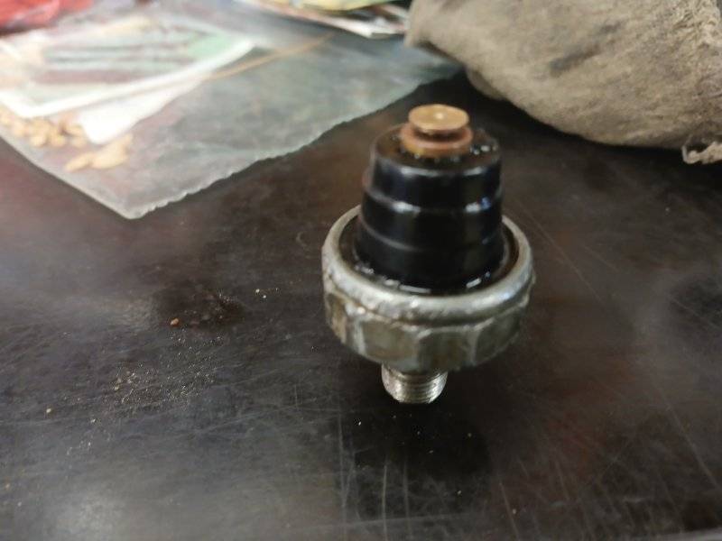

Add to that possible leak list the oil pressure sender.

You could nip up the oil pan bolts...& get lucky. But my guess is the rear seal or seal holder. When the engine is running, blowby increases pressure in the crankcase & helps find ' bad' seals.
Get a Harbor Freight $10 air regulator. Plug the dipstick tube and the breather hole in the valve cover. Use 3-5 psi (just enough so your finger over the end of the hose can stop the flow). Hook a hose from the regulator to the pcv hole in the valve cover. Spray the engine with soapy water and watch for bubbles. The leak will show up easily. Cheap and it works.

I chased a leak similar to your issue. Tried everything. In the end, it was this puppy that was my problem. Remove your oil sender unit and apply air pressure to the oil passage and watch for leakage.
I expected more of a mess after a couple years. Exhaust is really mess BEHIND the trans. It leaks oil, not trans fluid at all. I stay within an hour of the house because of the amount of oil I lose. Drips right from where trans and engine butt up in the center when parked but stops eventually. Seems to only do it when driving and gets blown all over the underneath I have more than great oil pressure and wonder if that has anything to do with it. It doesnt leak from the oil pressure sending unit, intake is sealed.....Blowing out the back corners of valve cover gaskets? Or is the seal obvious (never dealt with one)? I did wipe the bottom of the oil pan and center link off but there wasnt much oil on them. Thoughts? Ideas? View attachment 1891151View attachment 1891152View attachment 1891153View attachment 1891154View attachment 1891155View attachment 1891156View attachment 1891157
My cause of a leak was the oil pressure sending unit.

I agree with the Kimmer. Unless you cleaned it up before the pictures, any seepage looks to be from the pan rail area.
Keep in mind the two main seal retainer oil pan bolts can bottom out in the holes, as those bolt holes are shallower than the ones in the block...seen that mistake a few times. DVW's air compressor trick is a good one also. Baby powder is good for tracing an oil leak as well.
