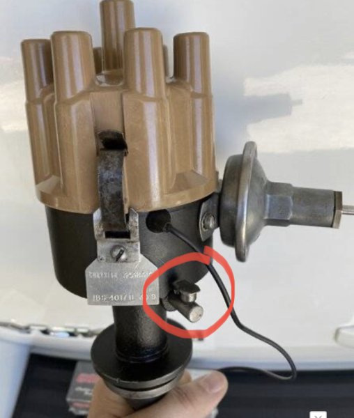

What’s is the small part circled in red in the picture attached? My distributor is not exactly the same but has that same part. It has a flap on top that seems to be spring loaded.

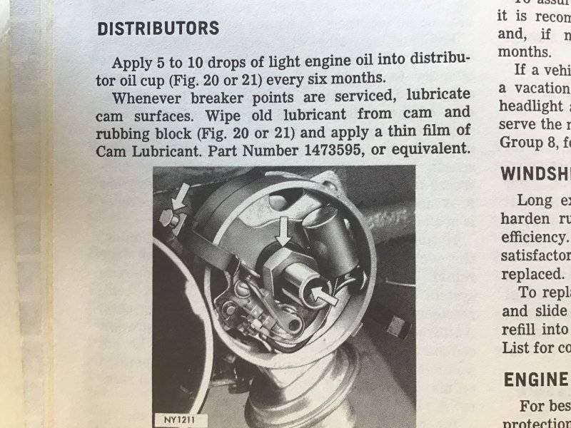

Basically a light engine oil
Read section 0 (zero) of your late 60’s or early 70’s factory service manual, lots of great info that few seem to know.
