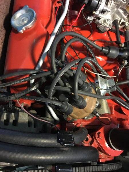

So I decided I’d change the cap, rotor, and wires on my 383 70 RR and realized that they were longer wires than normal. After looking around I figured out that they are the correct firing order but just starts two indexes on the cap from normal.

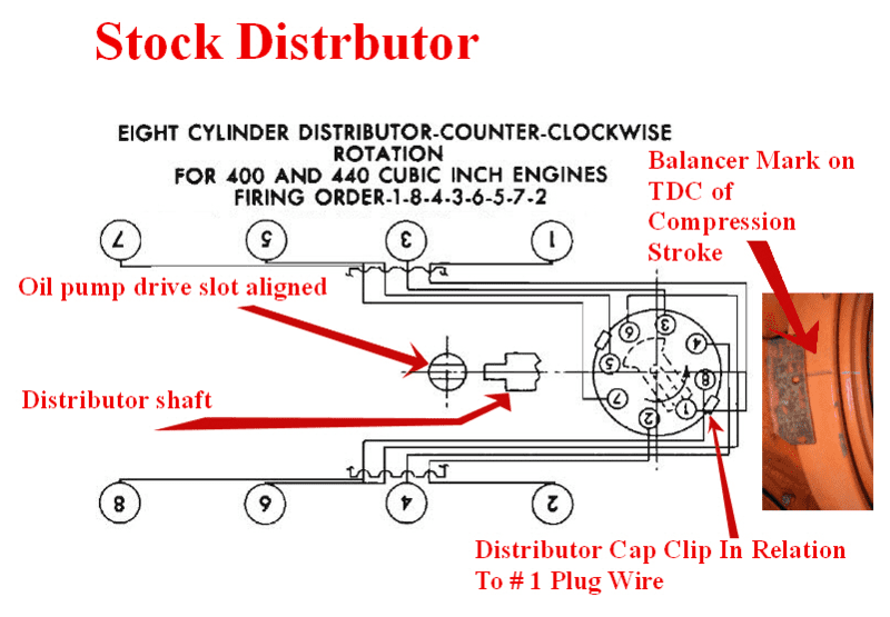

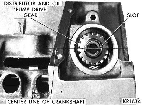

Pull number 1 plug. Bump it over until it is coming up on the compression stroke. Align the damper to the tdc mark on the timing tab. Pull your distributor and rotate the intermediate gear until it looks like this. Drop the distributor back in with the rotor pointing to the correct number one terminal. Put the wires on and set your timing.
