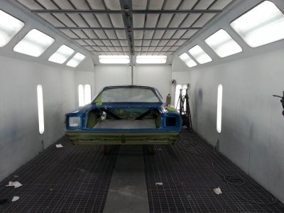

Not to burst your bubble but now you know why downdraft spraybooths are so expensive! If you're going to use the booth when it's 70 degrees out and all
of the shop doors open that's one thing. If you plan on using the booth when it's 30 degrees out, you have to exhaust the air outside the building and heat
the makeup air. And filter it. And filter the exhaust before you "dump" it outside. You can't exhaust the booth air inside the building with all of the reducer
and fumes from the activators or you'll die real soon! Downdraft in the center is definitely the way to go. No, you won't pull the paint under the car and
deposit it on the underside. (It doesn't happen in the bodyshop) A friend of mine got an old used Binks booth from a stealership that no longer did bodywork
and put it in his shop. Depends on how "Crazy" you want to get. You can put all of the systems together and make it work, but you need to look at someone's
booth and see if you can duplicate everything that's going on. Good luck wiyh the project! It can be done! 20130914_130931.jpg
