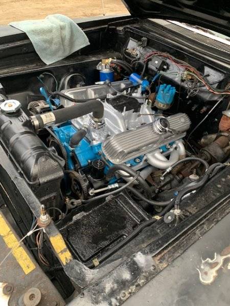

I had Hooker Super-Comps on my 360....it was tight..... so a 90-degree adaptor would be useful.

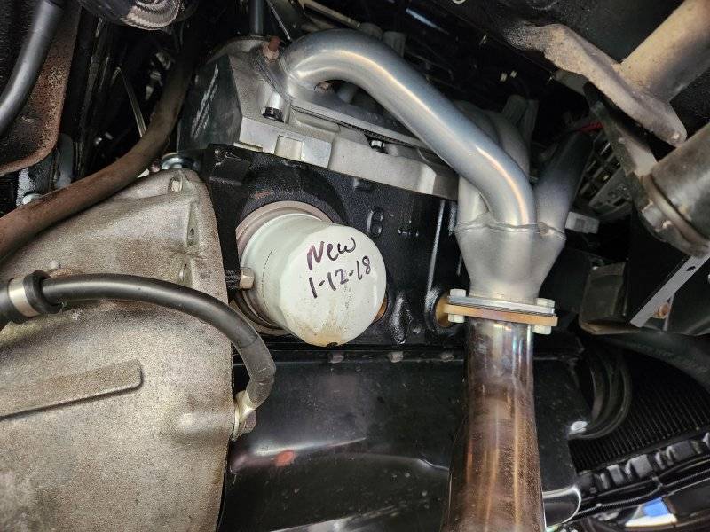

And after swapping out with Hugger Style headers by Patriot.......
****Please note that the filter and oil have been changed since this photo was taken. :lol:

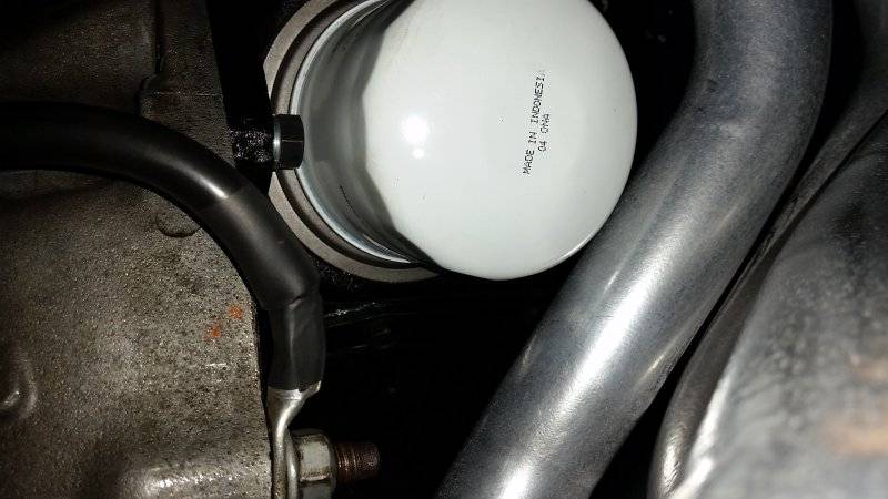

I also had to use a short filter due to headers.
If you don't object to a smaller filter Look up Wix 51516
