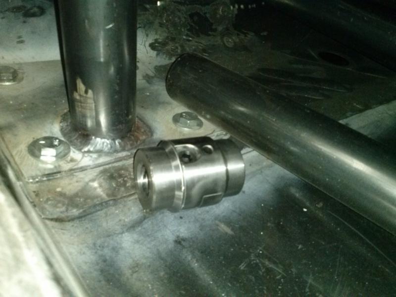

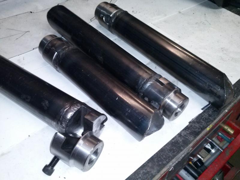

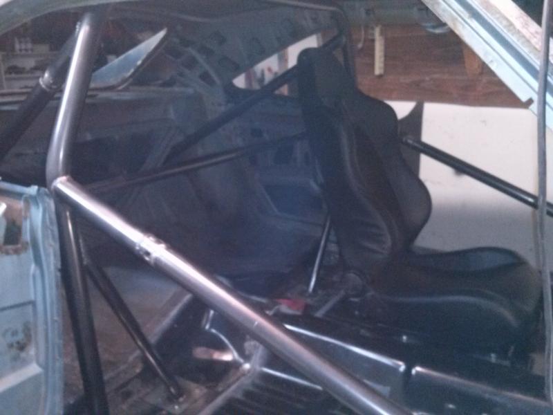

I put a $350 Jegs roll bar in mine that bolts with plates to the frame and subframe connectors, and added bars to make it a 10 point that connects from the shock towers to the frame at rear end hump. And it is nhra legal. I think a padded bar is ok on the street but have doubts about the safety of a cage without a helmet.
