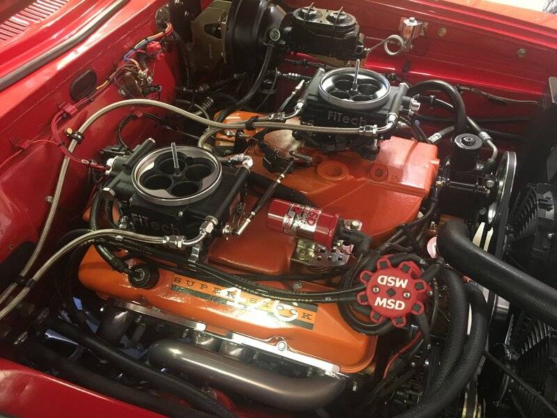

63 Plymouth Fury, Doug's headers (D452), Taylor 8mm wires with 135* boots. No sleeves, no burning...
looks excellent!! i bought the regular wire brackets for the 440. did you use them for all the wires plus the stainless ones for the #6 and #8 wires?
Thanks. I used the MSD composite separators. 2 wire ones in the rear on both banks and 4 wire ones going toward the driver's side. 135* boots on the Taylor wires. Universal, cut to length.
