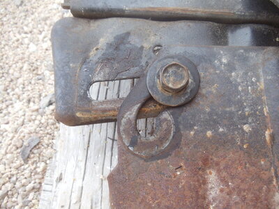

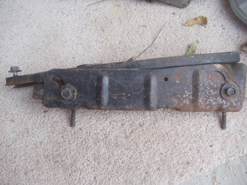

While cleaning up my '65 Barracuda bucket seat tracks (see photos) I found today there is an incline/tilt adjustment as well as a fore/aft adjustment built right in from the factory. Except for the six-way adjustable driver's seat option, do our BBodies afford any such adjustment? Thank you.

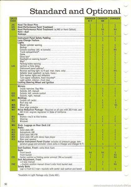

Code C62... Charger section of 71 Dealership book
just driver
same for 70
Not shown on earliers, neither A bodies from those years, but allways on the ones shown, just driver side

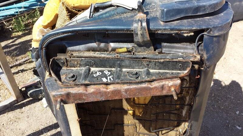

I might be thinking of 75/76 back recline that can bolt into 71-74.
(shhhhh, best kept secret) $20 M body power driver track is 95% the same as $800 "six way" power track.
I have added and removed donuts to get what I wanted. But no back only recline as the back safety latch doesn't allow for much.

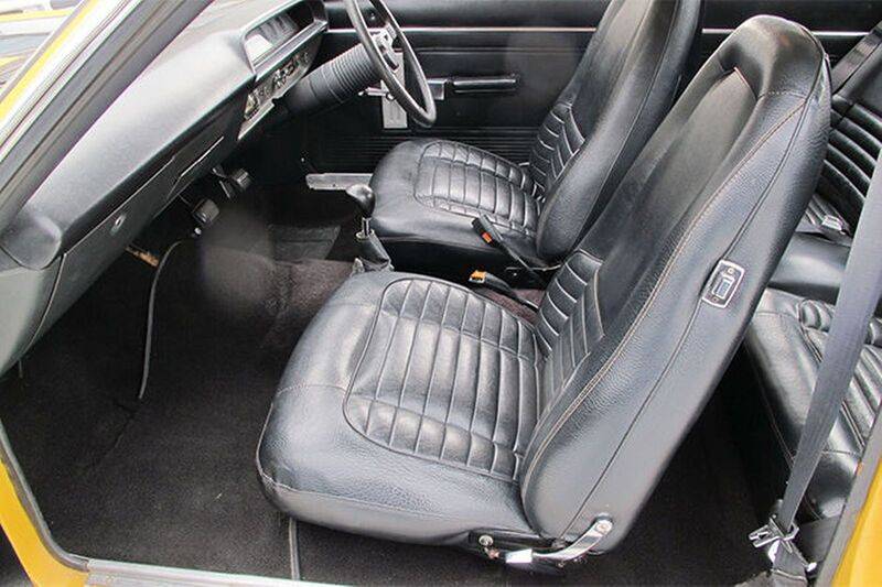

I know C-bodies had reclining front passenger seats. I had a 72 NYB with that option. I've seen it on a 70 Fury as well.
we had them from 71 VH valiant, they came as standard. the top button is to get into the car, the lower one is for recline
