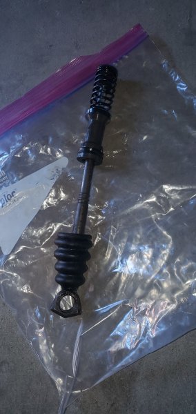

So I had the typical issue of having the annoying rubber grommet stuck in the old master, my master was so messed up that it came off and just left the piston assembly stuck to the pushrod.
I tried to pull the piston off the pushrod and after spraying some penetrant it actually came off. This is all to avoid removing the damn pushrod.
So I have the new master bench bled, a new dr diff grommet on the pushrod.
I'm about to install it and it pretty much sucks that the bolts want to sink back into the firewall and fall in, the pushrod doesn't want to slide in, **** starts to get heavy and I don't want to drop it so I try to pull it back and it also will not come out.
I pull harder and the damn piston pops out while still stuck to the pushrod since the new master only has a flimsy clip to old it in. sh**!

Does that rubber sleeve serve a good purpose? it's still sorta ok, but pretty filthy.
I guess it maybe went over this previous clip that kept the piston from popping out. The screws are gone or I'd reuse it since it's way sturdier than the flimsy soda pop can clip that came with the new master.

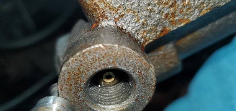

More problems today though. I'm having trouble around the flare nut, when I first tested the master it leaked a bunch when I pressed on the brake.
Today I tried reseating a couple times, but still didn't get it. After some research on the googles I may need to have the line perfectly set to align with the master. I looked at the flare and it seems fine. I used my phone like a borescope to take a look at the master. Going to try to set it again tomorrow or maybe tonight.
